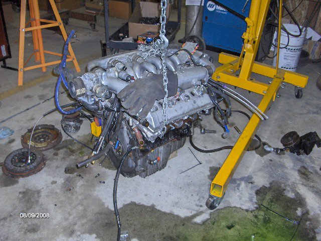

  10. I built new manifolds today... and some other things too.

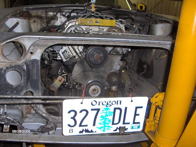

  11. There's no advantage for this swap (vs. VQ), just happened to have all the parts laying around... I like the iron block, good for boost. Not to mention the SHO has a completely different tone compared to the VQ. Oh well, its not like dropping a iron head 305 SBC... I'm sure the weight will be worth the power.
  12. Motor and transmission mount pictures... Anybody need a fresh L28 with a cam?
  13. Correct, I already lopped 1.5" off a spare pan and added large kickouts on each side of the sump....I'll do some kind of baffle or swinging door setup to keep slosh down. Amazing that hunk of a 6spd fits in there with reasonable clearance.
  14. I just checked hood clearance, with a 1/2" spacer under the intake I have 3/8 min clearance (modeling clay). the pan is getting kick outs on each side. Shifter will be easy to make work retaining stock location. I flipped the rear surge tank over and it clears the stock hood latch I'm going to mod a 350 CM flywheel for the SHO pattern and hub size. Its coming along nicely, no downsides yet.

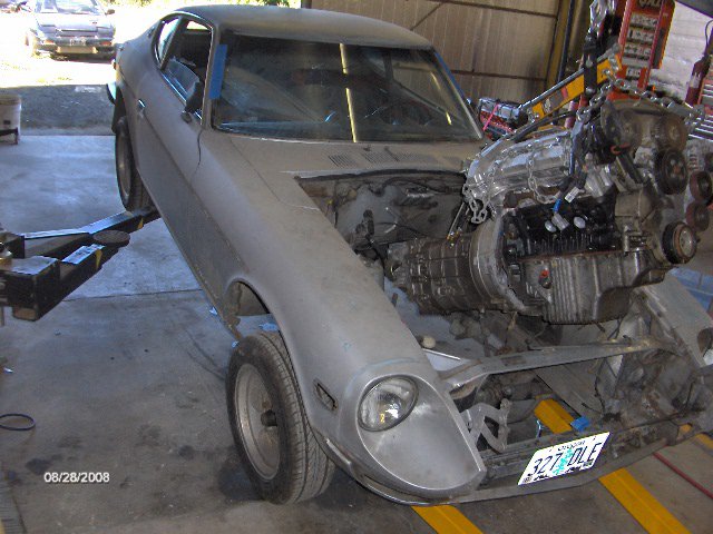

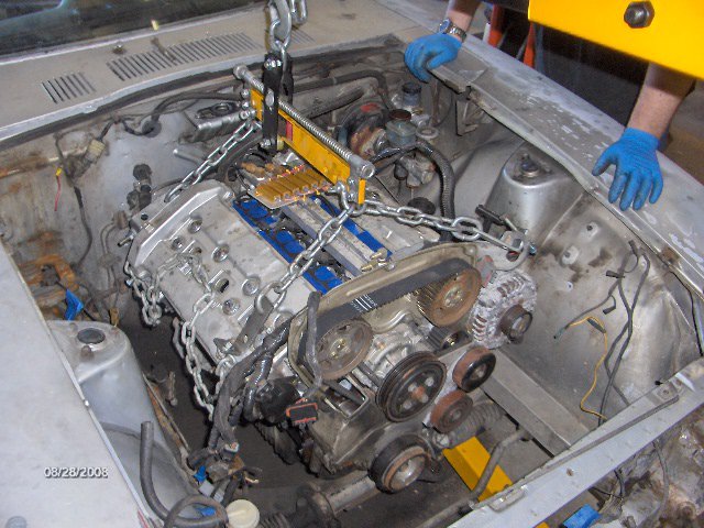

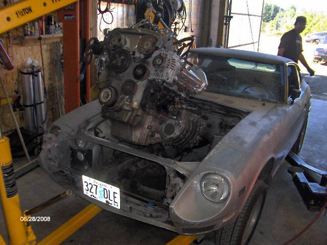

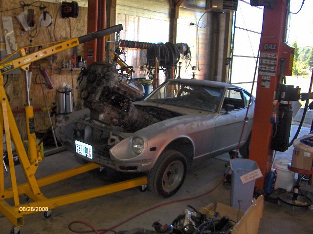

  15. Exciting day! lots of progress!

  20. Just savaged a spare SHO pan from the scrap bin... I might need to move my drains as well, maybe not. Sounds like modding the cam cover is sounding better to avoid having to lop a ton off the pan. Open cam covers would be neat if I could kept the crank sensor from getting crap in it. Maybe its time for my first dry sump I guarantee this one will happen one way or the other. Also I have the 3.2L Auto engine of which the pan maybe a little different. I remember something about the automatic's engine postion being a little different.

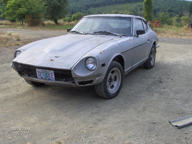

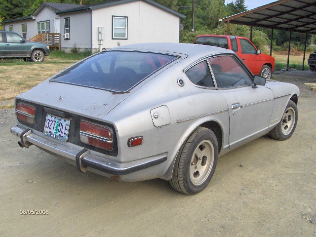

  23. Just picked up a 71 240Z today (needs some resto but its straight and rust/dent free) that will be getting my built TT SHO engine from my old Probe . I've been looking for a good home for my engine since I'm disgusted with my old probe... I've had it for over 10 years and it just rots in my driveway since I refuse to drive a FWD peg leg mobile. But before I parked it I did a FULL build on the SHO engine, Large T28 turbos, etc. The intake will be turned around and installed waaaay back on the S30. THe engine was already setup and tuned on a Haltech E6X so a nice fresh harness will have it running in no time. Thought I'd share... We'll be starting on it this winter.
