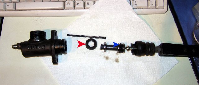

  1. Update. Sent my master cylinder away to Tilton reps in UK. Both seals were like jelly. Something in the fluid had made the seals swell and fall off ( well the end seal fell off ) Know idea what could have done this. Used Dot 4 Carlube fuid. Had a new seal kit fitted and will install next Monday after a good flushing through, hoping the slave hasn't got the same plague!!
