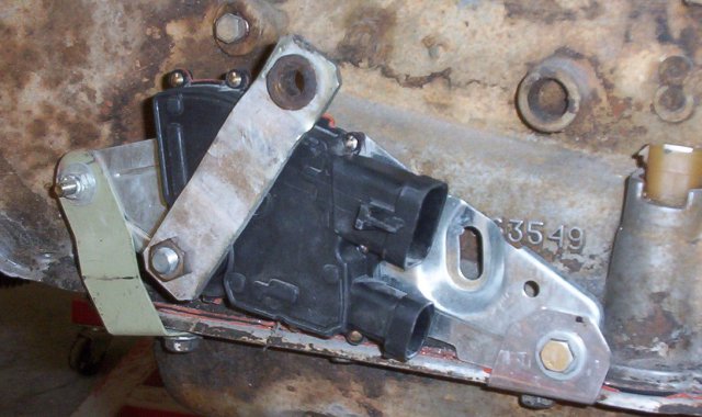

Okay, I feel like a complete idiot. After several days of fiddling with the ohm meter and the switch I finally decided to double check that it was mounted properly even though I would've bet a million dollars that it was aligned when I bolted it to the brackets. It took me 30 secs to remove the shift lever only to find that it was off (rotated) by a good 20 degrees. Once I aligned the marks in neutral I found the wires within 5 minutes. Bad news...I feel really stupid...good news...the engine is ready to go in for the last time! Moral- Check then re-check even if your SURE you did it right... Regards, Tim -

GetZ, Thanks for the info but I need the pinouts for the Park-Neutral switch on the transmission. I'm going to just take the wire that goes to the starter solenoid and run it throught this switch so that the starter is interupted unless it is in Park or neutral (this was how it was wired on the original Datsun automatic transmission). I've checked every possible combination of terminals but cannot find the two pins that complete a circuit while in park and neutral. JTR shows the switch and gives the part number but doesn't tell how to wire it up...I think that I'm about to forego the park-neutral switch and just install the engine with no safety switch. Thanks again though for your input. Regards, Tim -

Hi all, I've installed a park neutral switch off of a late model Chevy onto my 700R4 per JTR manual. The part has 2 receptors for plugs- top having 7 prongs and bottom having 4. I thought it would be easy using my ohm meter to find the terminals I needed for the reverse lights and the park-neutral switch but I can only come up with the reverse switch. No other two terminals give me a closed circuit on the park and neutral positions only. I have searched this extensively and even tried to revive an old thread in the electrical forum but no luck. Does anyone know the wiring/pinouts for this type of switch? This is the last thing I need to do before I install my engine permanently and would like to get it done over the holidays. Any help would be greatly appreciated. Thanks, Tim '76 280Z w/'99 Chevy Truck Vortec engine
Thought I would awaken this thread...does anyone have any info? Tim 76 280Z w/ JTR conversion, 5.7 Vortec engine from 99 Chevy Truck-almost finished
