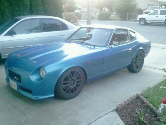

Hi guys. Looking to get rid of my snub nosed Z and return it to stock minus bumper, plan on getting an MSA air damn. I am going for an "open nose" I am sure you guys know what I am talking about. So anyways. I am going to need a new hood (mines chopped by 9 inches) Fenders (mine are blended into the bumper) Both headlight buckets and...thats it I think just buy the MSA front Air damn and I will be cooking with gas. Oh and a grill, stock or aftermarket billet? any reccomendation just looking for something to keep the birds out of my radiator. ..and I guess ill need hood hinges etc etc I am thinking more and more towards junk yard (if I can find a 260z) but if you guys know a guy or know a place or have any good things to say about XYZ let me know 8D

I recently purchased a 260z and am wanting to go a different direction than the PO I am looking for someone that is willing to swap me front fenders bumper and hood. The Closer to Chico, CA the better but I am willing to drive. Front end Screams Muscle and I am more of a JDM guy so hopefully I can find someone that can enjoy the front end more than I can. Bumper was personally hand laid and is a one off. You will not find another front like this anywhere. Bumper was shaved into the fenders so it comes off as one piece. Hood was also shortened and will come with the bumper including all pins. Bumper is 9 inches shorter than stock. Bumper is Aerodynamically awesome too! email, text, call bertio.jones@gmail.com 530-200-7703

Yeah the nose is a love it or hate it affair. To me its functional and it takes about 9 inches off the front and makes it to where I don't have to deal with that horrible front bumper. As for the spacers im still on the fence after a lot of reading. The spacers I have are hubcentric and 26mm (about an inch) they are not the spacers that have their own set of studs they require longer studs from the back of the hubs so from my research makes them safer as the rim mates flush and is attached to the original studs that have been pressed in. As long as your studs are in good shape you shouldn't see any shearing because the spacers are hubcentric. The brake issue seems that since I have larger 4 pots in the front my mc might now be up to snuff. I have found some 15/16 bmc locally for 35 to 50 bucks (rebuilt) otherwise they are 130 to 200 new hopefully that fixes my issue. -
