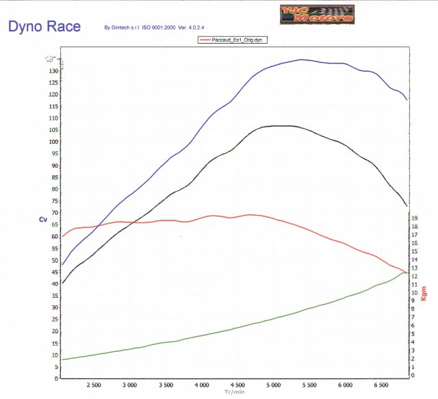

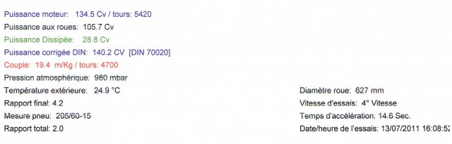

Here is the result:
Good just below the origin, normal for the kms...

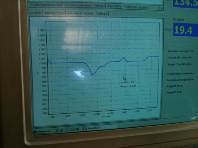

and here is also the lambda result, normal tune for economy...
