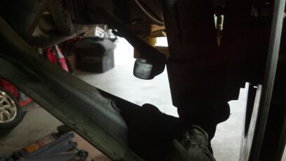

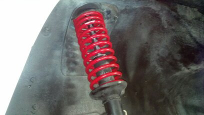

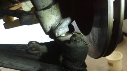

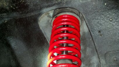

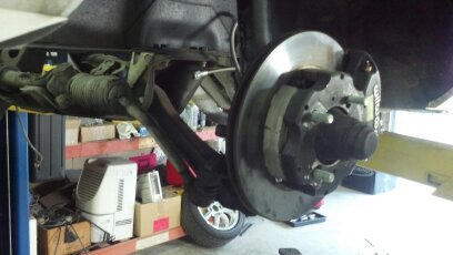

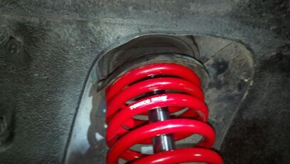

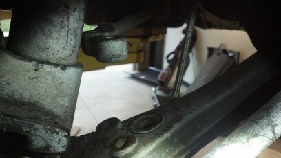

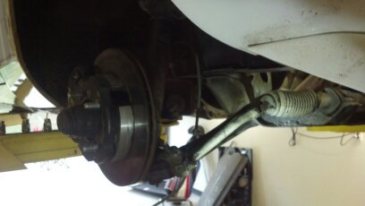

We replaced the suspension on the '73 240Z today. We installed Tokico Illumina Adjustable-5 struts with Tokico springs. Part numbers 5020 for springs. We've only attempted to reinstall the fronts so far because we encountered an issue. During reassembly we noticed a major alignment issue between the transverse link and the compression rod (both sides of the car). It appears that the strut assemblies are far longer than stock and therefore are pushing the transverse links down at an angle even when bolted to the strut towers up top. We checked all of the part numbers and we believe the struts and springs to be correct. We cannot diagnose the issue other than the fact that we think the assembly is too long. We're wondering if the rubber stops at the top of the strut assembly are too thick? I'm not sure. I've searched all of the forums and googled everywhere for this and I found nothing. There were people have trouble with Tokicos but it was always related to the ride, bump steer, too high, too low, etc. Nothing like this. I've attached some pictures. Thanks for any help.
