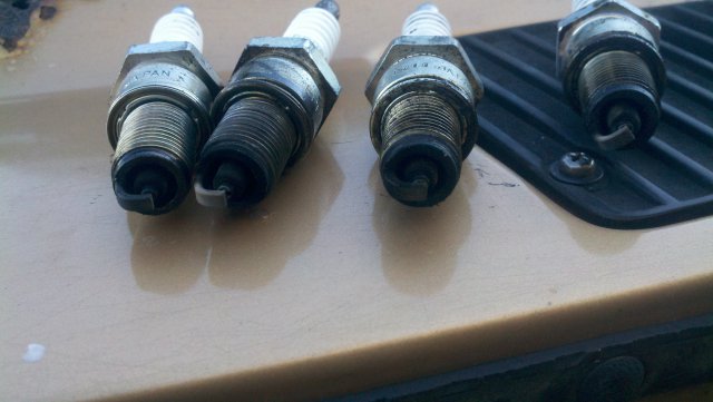

So I have been having loss of power after 3500k rpm and it not really being able to break 4k rpm under load, my gas mileage is not doing to great either. I found that my #6 cylinder was not firing, replaced plug (was very dark and fouled most likely from problem with CSV that was been fixed as well) so thats correct now. Fuel pressure is holding at a steady 32-35PSI. I switched to dished pistons per furture turbo build from the flat tops (f54/p90acombo) so obviously I'm running a lower compression ratio. Ran car for a week and just pulled plugs to look at them. #6 still looks a little darker then it should be but 5-4-3-2-1 are looking lighter then they should be so I believe I'm running lean, is this correct? How do I tune my AFM correctly? Searched for it but I was hoping to find a more picture by picture instructions on how to do this.
Which one are you at? Im pretty basic when it comes to figuring this out. My fuel pressure is at about 32-34lb. #6 cylinder wasn't firing, replaced plug and wire and that solved that but it still has problems breaking 4k and power still doesn't feel quite right.
