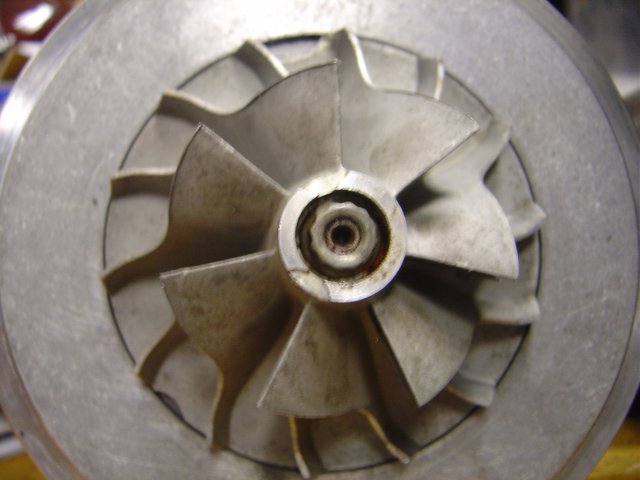

Well I sent the turbo to the good folk at G-POP Shop. They confirmed that it was pretty trashed and for a reason, the turbo wasn’t a good fit to begin with with regard to the size and ratio of the wheels and the application. Basic comment was that the bearing wear was premature due to being too large for the application (or something to that effect). They helped me size one using my old core as core. They got my water cooling that I wanted and I can swap in ball bearings later. So the moral of the story for me was that in spite of all of the research I did prior to getting a turbo (I became a car guy only during the multiyear rebuild, I didn’t know what everything under the hood was when I first popped it) that getting hooked up with a good resource can really address answers to questions I didn’t yet know to ask, especially with regard to something that needed to be “balanced” with my application. BH

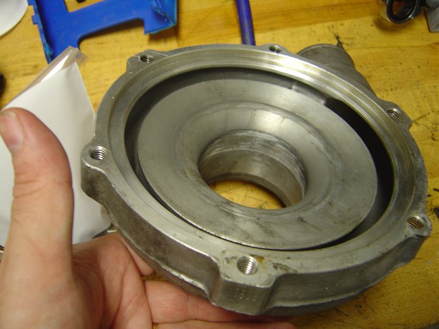

Any place I can get a blow up dwg and torque/rebuild specs for the T3/T4? Someone asked if maybe I was missing a gasket on my turbo which is causing the housing to rub, to which my reply would be that if the guy who had the turbo before me (used but looks low mileage) lost it I would never know. Can a turbo be checked with an oil supply and compressed air on the bench or do I have to bolt it back on to find out if a problem is better or worse? thanks, Bil
I will have to look at it from a front to back clearance point of view. I guess I didn't mention, this is a Garrett T3/T4 .49/.63 if I remember correctly. Spent about $5-600 on it originally, just didn't get to using it until recently. Any place I can get a blow up dwg and torque/rebuild specs for the T3/T4? If the guy who sold it to me lost the gasket, I would never know. Can these things be checked with an oil supply and compressed air or do I have to bolt it on to find out if it is (mostly) sound? Thanks for all of the help. Bil

As I look at it it would seem that there is more of a controlled radius to the pieces then I though originally. The fact that they almost line up with the material removed from the nut would tend to mean that these are balancing cuts also I assume. That takes me back to why I pulled this out. no boost and above 3k the turbo made a "raucous noise" and impeller was clearly rubbing if not slightly gouging the housing. There is a slight wobble to the shaft, .007, that I assumed meant that at any high speed it would be acting badly, the housing wasn't just worn on one side, it was all the way around. Is there a way to test for basic soundness before bolting back on the car? This turbo is fairly clean, I don't think it has a lot of miles on it and no signs of oil anywhere, I didn't think of it as a candidate for a rebuild as it acts broken, not worn out. Thanx again. (Nice silver z) Bil
Thanks for the reply. I circled the two areas where there are pieces of the wheel missing. The housing is pretty gouged where the wheel was off center at speed and the spindle doesn't have any fore/aft play but it wobbles from being bent. If the wheel is supposed to have those pieces missing (where you can see thru to the bottom part of teh housing) that will save me from trying to track down if the metal got sucked into the plumbing/engine. Bil

I just put the first few miles on my 83ZXT after a long rebuild. I had bought a T3/T4 from a guy back when I started, who sold it with some other parts as kind of a kit. It was used and now I suspect it might have been no good to him due to it's condition. I rebuilt the engine (3.0L) along the way, the engine came to life okay and everything was normal (even flew right through inspection) until I went to run it on the road under load. No boost and above 3k the turbo made the bad kind of noise. I tore down to it and noticed the turbine had rubbed all the way around in the inlet area, when I took the turbine housing off two vanes where chipped (12:00 and 8:00 in the picture) and the shaft has .007 wobble. So is this re-buildable or should I start saving for a new one? Obviously I would need new turbine, etc. This Turbo has a water cooled center section, Can I transfer the center section to a new turbo where everything else is the same overall? I am seeing a lot of "new" T3/T4 imports on eBay for $200, anybody have any experience with the imports as opposed to the Turbonetics or Garretts? Thanks, Bil
