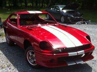

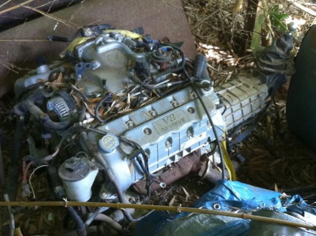

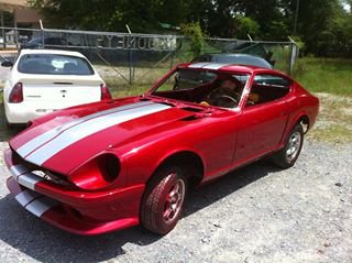

Well I've read the posting by by the other members on their 4.6 dohc builds and am ready to start. My body shop needed cut me a deal to leave the chassis with them this winter to be a "rainy" day project. After nine months it's back. Since the car is painted before the build I'll be stripping all the sheet metal off agin and storing it while we work on putting the engine and systems in place. Then touch up to paint and finish the car.
My order of work will be suspension, electric, then the motor goes in and we work on interior. Thanks to stock4now for a rust free chassis he sold me for this project.
The pictures are the chassis back from paint and the engine/tranny from the 2001 cobra.
One thing about this build that will be different. I've going to try and swap in a cobra dash and pedal set. If I can figure that out, everything gets easier. Engine, tranny, A/C all of it. Since there is nothing in the car now why not...
Greg
