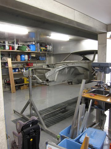

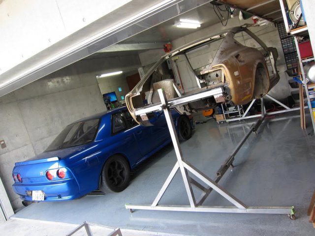

After much consideration I've decided on doing an N/A VH45 swap into my Datsun 260Z. My car is a 74 which was purchased in San Diego then brought to Okinawa when I moved back here about 5 years ago. I've been doing a restoration on and off for a WHILE. But I've also been busy building a house and family. Things are finally starting to settle down and now I've got some time to work on the Z again and a place to do it; my garage. Here are my rough plans: install stock rear-member/diff get the car back to a rolling chassis install VH45 and Z32 mission with mazworx adapter plate custom drive shaft to be installed only for JCI with stock rear end Get JCI done and generate Japanese title, complete legitimate Konin for the car with the engine and transmission on the title drop the stock rear member and pull the motor/mission out again start hacking up the back frame/floor and modify the car to accept a totally unmodified BCNR33 rear member Get back to a rolling chassis with the new rear end in Put the motor/mission back in Design roll cage system cut up piping for roll cage and mock it up Pull motor/mission weld in roll cage stitch weld all panels on the unibody and incorporate the roll cage into the body everywhere possible full paint underside/interior/engine room/etc... reinstall engine/mission custom driveshaft for the BCNR33 rear end Put fenders/hood/doors/hatch back on and final paint. reinstall glass, finish wiring, finish interior, etc... then it should be pretty well done. I'm expecting this to take a few years. maybe more than a few. I was going to do an SR20, but had a good friend beg me not to. I'm concerned that there are many build threads on VH45 Z's but I never see any of them complete.
