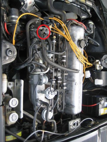

Hi guys, so my 280z is finally up and running pretty good, however it has a light knock. when i first got the car about a month ago i figured it was due to bad timing or the god awful old sludgy oil that was in the engine, well i adjusted the timing to factory settings, seafoamed the engine and changed the oil and the knock still remains. so i figured my valves could be out of adjustment, so i had a local shop adjust them and it turns out they were off spec, but still the knock persists. at this point unless i have a bent valve (which it doesnt sound like) i was thinking that perhaps my timing chain is rattling against something? i did notice when i changed my valve cover gasket that the chain wasnt completely tentioned extremely tight. so my question to you is could this perhaps be that my timing chain or tentioner is worn causing this sound? The car has 125,000 miles on it so if they timing set has never been changed it seems like it might be about that time to change it. I will be posting a video of the knock tommorrow
So just an update, i replaced the vlave cover gasket, this time i sanded the **** out of any place that could potentially cause a vaccum leak, so when i put the gasket back on everything was smooth, i then beaded oil on the gasket and put the valve cover back on, fired her up and still runnin like ****, i tested it with a vaccume tester again, and it was at 13 psi at idle like it had been before i changed it. so i took it to a local shop to have them diagnose the vaccume leak source.
Fuel Filter apears to be new, fuel pump is new, fuel pressure set to 36 psi, not sure on the timing, however the car was only sitting in my drve way and i would start it up and let it idle every day, i havent been driving it since the clutch went out. it was idling fine until i removed the valve cover to clean and replace the original gasket, i used a new gasket and sealent on the valve cover and put it back on the engine, i then started her up about an hour later and she starting running like ****, as i described. so i am going to remove the valve cover, put on the gasket this time without sealent and tighten it up nicley to see if that gets rid of the vaccume leak. that is the only thing i can thing it might be (most of the time something like this happens, it seems to be part of a human error). ill let you guys know if that was the source of the vaccume leak
so my car began doing all the symptoms of a bad airflow meter, so i took it to a shop for diagnosis. they confirmed my suspicion that it was a bad airflow meter and a clogged egr system. I replaced the air flow meter, and unclogged the EGR system and replaced the EGR valve, however the problem still persists. the car idles poorly and misfires under acceleration. it sounds like its not running on all cylinders. All the injectors were tested to be working, and when i try to adjust the idle using the idle screw it doesn't seem to respond much to it. Also if i take the oil cap off when the car is running it doesn't run any different (i Believe the engine is supposed to die if you do that). So Hybrid Z community, what are your thoughts on the cause of this problem, i dont want to keep throwing money at parts that arent causing the problem. Car is a 1977 280z
