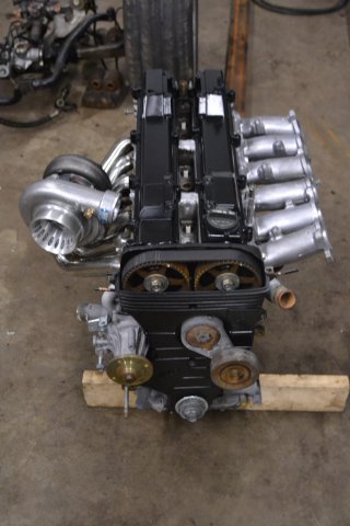

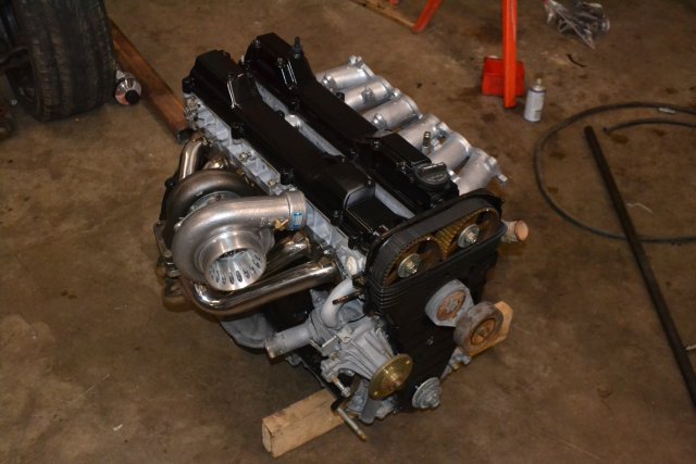

  2. floydfan_90
    a more involved z build!
    just some pics of the 2J cleaned up with manifold and temporary turbo mocked up
