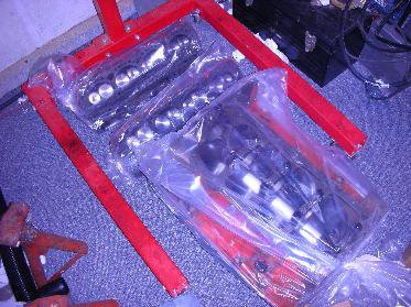

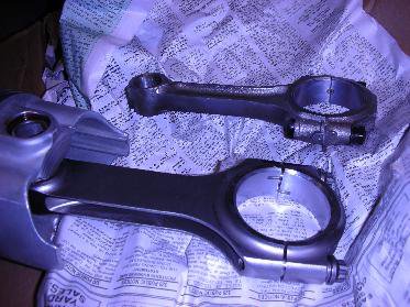

Also got my motor back from Taylor last week (Probably the best machine shop around). I can't wait to hear this thing run. It's a 60 over 283 (292) w/ scat h-beams, forged domed pistons should give me 10:1, 462 casting heads, debating what intake to run, Comp 230/236 @ 50; 480/486 lift. This will be a daily driver so I didn't want to go too crazy with the motor. It'll be running a 150-250 shot when necessary.
(yes it's running two bolt mains... I'm not worried about it with a 3" stroke. I've talked to a lot of people about this setup and I'm convinced that it'll be fine. Running the numbers puts this motor @ 8000 rpm before piston speed becomes an issue with two bolt mains and this cam runs out @ around 7250;-))
