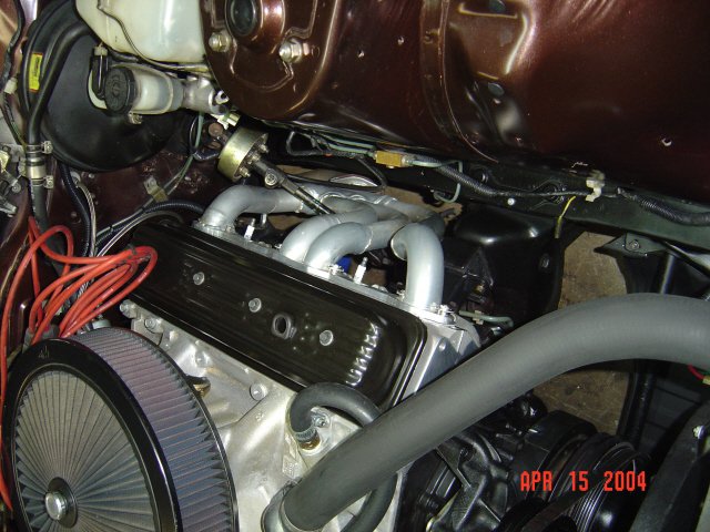

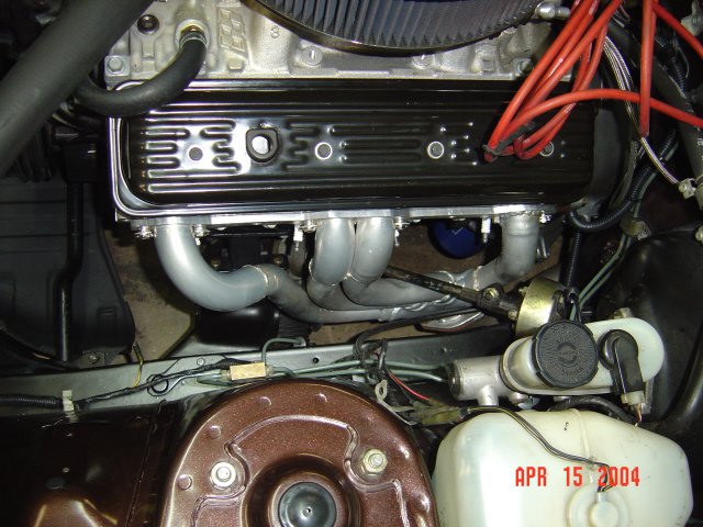

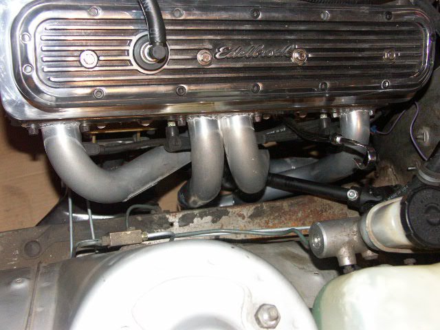

I completed the sbc conversion in my 83 ZXT. I originally had power rack steering but had to give it up in favor of the manual rack to allow the headers to free flow on the driver side. There may have been a better solution, which I lament bcause I do miss the power steering. If you can find a way to fabricate the headers around that steering assembly in the 83 model you will be among the few. Here are a few pics from a few angles of how we ran the steering rod. DanJ -

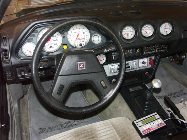

	PurePontiacKid The Tach is AutoMeter UltraLite Memory Pro Comp 5". I believe the part number is #4494. http://www.autometer.com/cat_gaugedetail.aspx?gid=3145&sid=11 One thing I like about the guage configuration is that the 5" and smaller guages (2 1/16" I believe) fit right into the stock ZX dash with no fabrication required. Gives a nice sporty stock look. The speedo guage lets you calibrate the speedometer to any rear/tire configuration to reatin accuracy. I have pondered the wheel/tire possibilities for a long time. I would even stick with 15" rims if I could get the right tires for steering up front and launch in the rear. I had to convert from power rack to manual rack steering to install the driver side full-flow headers to install, so I need to stick with no wider than say 205 tires up front but would like 235 or larger on the rear without too much change in O.D. to keep rear ratio near 3:54 or lower. Thanks for all input. DanJ

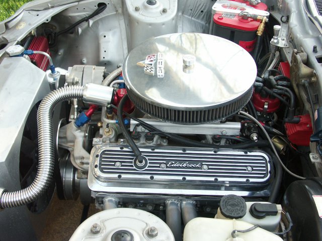

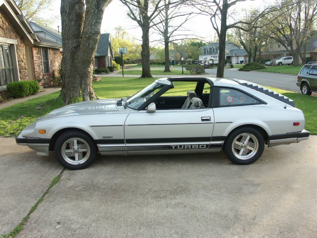

	Here's a few pics of my S130 ride. 383 sbc stroker, 700R4 tranny, Edelbrock EFI, MSI, Mallory, free flow headers. Getting ready for some Spring mods to the car. Wheels and tires are 1st on the list. Thinking 17 X 8 wheels on the front and 17 X 9.5 or so on the rear. Don't want to do any fender mods and would like to keep spacing and adapters to a minimum. Not much to pick from in the 4 X 114.3 lug configuration. Also, will be installing new carpeting and headliner with kits from ZCar Parts. Next would be a swap of the stock R200 3:54 rear for a 87-89 300ZX 3.7 LSD rear. Any thoughts, comments, questions, criticisms, or advice is invited. DanJ
