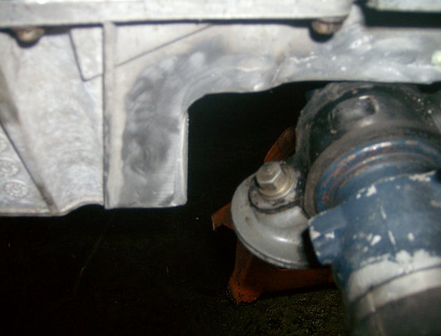

On the oil pan if you measure from the bellhousing flange toward the front you will make your cut at 10", cut up toward the pan rail till you are even with the most shallow part of the pan, cut forward at least 5" I will try to get pics of my cut out sorry guys I didn't get a pic of the pan.
