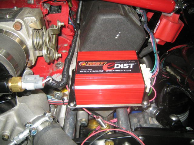

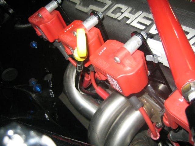

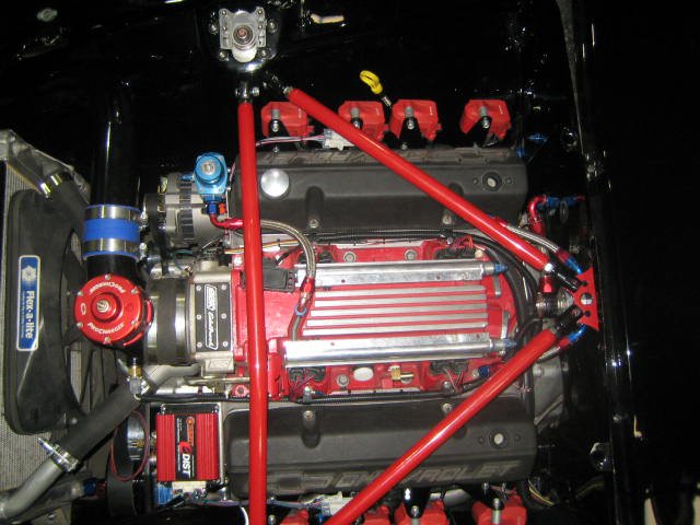

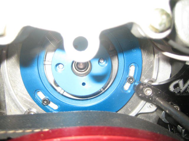

No, its a cam sensor that martin motion in Huston Texas makes. He uses a MSD inductive pickup. You also have to use a crank trigger with it. This motor uses the coil on plug setup with the fast EDIST BOX to fire the plugs. It works really well but is really expensive.  Your better off just buying an LS1 motor  and all this stuff is basically already done for you.
