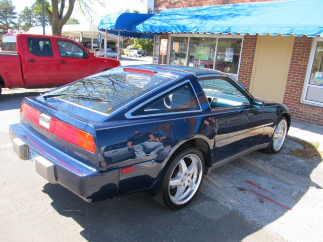

  4. OK, I got one in. Hmmm. Let me try to show you the Turbo 4 cyl in the MGB. AHHHAAAA, And now that I have become an expert at this, here are some more of the Blue Z.

  8. Given the immense progress in the development of V6 engines in both power and efficiency, I am considering a late model American engine/transmission for my '88 Z31.I've done a brief look through the history here but only found references to V35de swaps. I don't know that there is any particular advantage to using a late model Nissan engine rather than a Ford V6, for example. What have others done and do others perceive advantages to using a late model Z engine? By the way, I ended up with the project car while looking for a fender for my '87Z, since sold. It had a relatively rare in my experience, factory blue color and was just too sound and straight to part out. Many thousands of dollars later, because even VERY sound cars that have been sitting for 5 years (rabbit living under the hood) require considerable work, the car has just come out of the paint shop. If someone will advise on how to add pictures, I'd love to share some with you.
