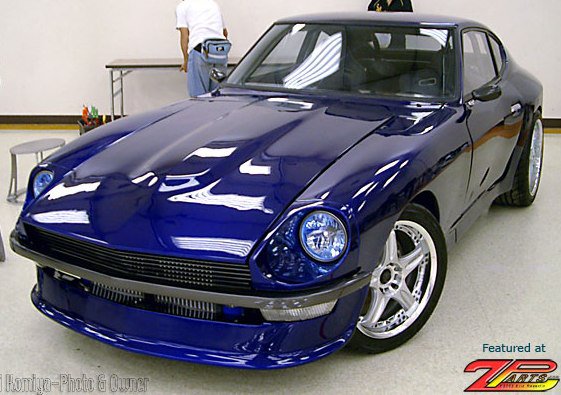

Well, since Yuki Komiya's Z color is not available then it looks like the choice is clear. I vote for Interlagos blue don't you agree? -

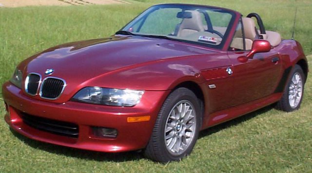

I think I've given up on the blue but still considering the silver and red. My issue is that I see allot of nice reds but can't find the code or name. Here's one that I'm considering. If anybody has any reds I should look at please feel free to show me. Thanks

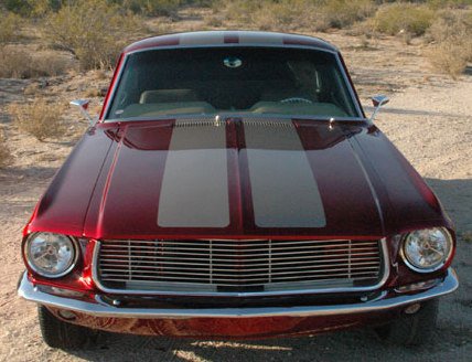

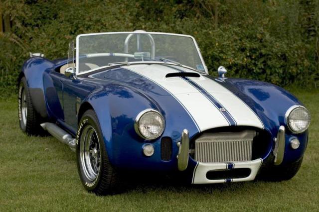

Hi guys, I’m about finished with the body work on my 1978 280Z 2+2 and I’m loosing sleep over what color to paint her. Guys, I need your help in choosing a color, I’ve posted three pictures of the colors I’m considering and most likely I will go with racing stripes in a dark gray like graphite except on the silver/gray, I’ll use white or a lighter shade of the same color. Thanks, Rick
