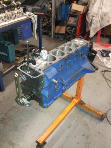

I don't make it on here enough and probably should have consulted this great knowledge-base more thoroughly when I was building my setup. My car had an L26 originally, I sourced an L28E and rebuilt it. It's an N42 block and N42 head also I think? The bores were corroded so I sourced some .030" (I believe) oversized hypereutectic pistons, Hastings chrome rings, and the motor was mostly standard apart from some cooling system alterations, standard camshaft & RPM range, etc.

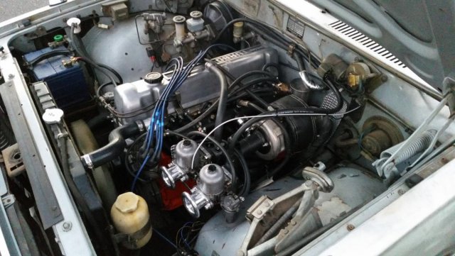

After driving it part time for a year, I pulled it off the road and set up a Draw-Thru Turbo system (I sourced a used kit that I modified to suit my engine bay) and when I got that running, I struggled to get the tune and boost-retard function working well, I babied it around a little and tried to get it better but ultimately I had big oil consumption issues (blowing out the tail pipe on boost).
