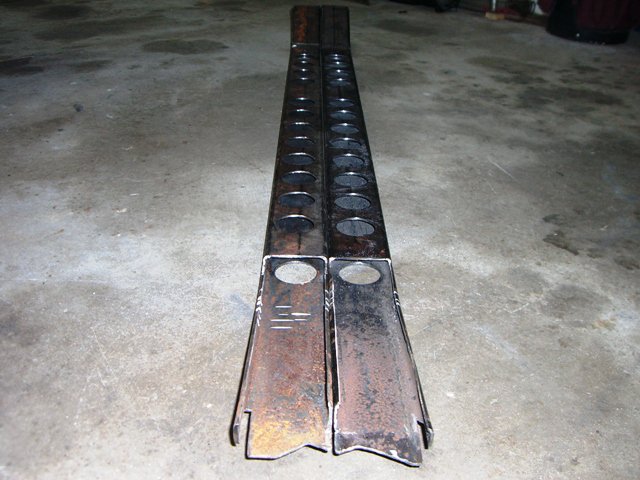

The one time I borrowed a friend's G-Tech Pro, my car reached 1.20 lateral gs in a sweeper on an autocross course. I use 225 lb springs and 225 mm wide tires. Since I use the car for autocrossing and track days, I don't think an X brace is "just adding weight," especially since you can literally hear the car creak if you jack it up at the stock jack locations (near the tires). If I was building a drag car then, yes, an X brace would be useless weight, but then so would sway bars, strut tower braces, 225 mm wide front tires, and basically anything that helps the car actually turn. My original question was just asking if to find if there was extra weight that could be removed without sacrificing strength. If I could remove a pound or two of weight without sacrificing strength, then that weight would have been truly useless weight (every little bit helps, its what enabled me to pass an 07 Vette at the last track day). That doesn't seem to be the case though. Pete -

Ok, thanks for the feed back. I am not going to drill any lightening holes. How about this idea? I was thinking that an X brace between the frame rails would really help stiffen the car. The drive shaft and exhaust pose the most immediate challenge, but then I thought of an X brace with an integrated drive shaft / exhaust hoop. What do you guys think of that idea? Doable? Pete -

I got my Bad Dog SFCs today! I haven't given them a test fit yet, but they look good! I am pleased. They don't weigh all that much, but I was wondering if drilling lightening holes in them would make them weaker. I tried to attach a picture of what I have in mind. Hopefully it will work. I don't think the SFCs in the picture are Bad Dog parts, but it gives you the idea. In case the picture doesn't come through, I was thinking of using a 1.75" hole saw to drill a hole every 4 to 6 inches or so. Would this weaken my new pieces? Pete Sprenger 1972 240Z
