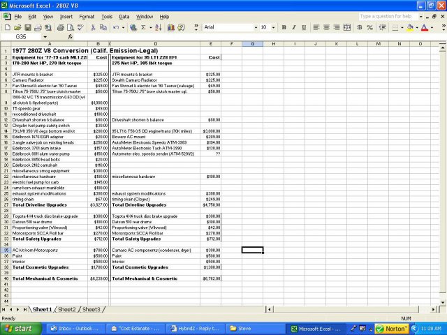

This is getting annoying, but I think I figured out how to get it sent in a readable format. (Last attempt) Equipment for '77-79 carb ML1 Z28 Cost 170-200 Net HP, 270 lbft torque JTR mounts & bracket $325.00 Camaro Radiator $225.00 Fan Shroud & electric fan '90 Taurus $49.00 Tilton 75-750U .75" bore clutch master $50.00 1988-92 WC T5 transmission 0.63 OD (w/ all clutch & flywheel parts) $1,000.00 T5 speedo gear $49.00 reconditioned driveshaft $100.00 Driveshaft shorten & balance $80.00 Chrysler fuel pump safety switch $30.00 79 LM1 350 V8 Jegs bottom end kit $200.00 Edelbrock 1476 EGR adapter $20.00 3 angle valve job on existing heads $250.00 Edelbrock 3701 alum intake $157.00 Edelbrock 8811 alum water pump $150.00 Edelbrock 8850 head bolts $20.00 Edelbrock 2102 camshaft $110.00 miscellaneous smog equipment $300.00 miscellaneous hardware $100.00 electric fuel pump for carb $145.00 rams horn exhaust manifolds $100.00 exhaust system modifications $300.00 timing chain $67.00 Total Driveline Upgrades $3,827.00 Toyota 4X4 truck disc brake upgrade $300.00 Datsun 510 rear drums $100.00 Proportioning valve (Wilwood) $42.00 Motorsports SCCA Roll bar $270.00 Total Safety Upgrades $712.00 AC kit from Motorsports $700.00 Paint $500.00 Interior $500.00 Total Cosmetic Upgrades $1,700.00 Total Mechanical & Cosmetic ******************************************************************************************** Equipment for 95 LT1 Z28 EFI Cost 275 Net HP, 305 lbft torque JTR mounts & bracket $325.00 Stealth Camaro Radiator $225.00 Fan Shroud & electric fan '90 Taurus (salvage) $49.00 Tilton 75-750U .75" bore clutch master cyl. $50.00 Driveshaft shorten & balance $80.00 95 LT1 & T56 0.5 OD engine/trans (70K miles) $3,000.00 Bowers AC mount $289.00 AutoMeter Electronic Speedo ATM-3989 $194.00 AutoMeter Electronic Tach ATM-3990 $138.00 Autometer elec. speedo sender (ATM-5291/2) ?? miscellaneous hardware $100.00 exhaust system modifications $300.00 timing chain (Cloyes) $249.00 Total Driveline Upgrades $4,750.00 Toyota 4X4 truck disc brake upgrade $300.00 Datsun 510 rear drums $100.00 Proportioning valve (Wilwood) $42.00 Motorsports SCCA Roll bar $270.00 Total Safety Upgrades $712.00 Camaro AC components (condenser, dryer) $300.00 Paint $500.00 Interior $500.00 Total Cosmetic Upgrades $1,300.00 Total Mechanical & Cosmetic $6,762.00 $6,239.00 -

Guys, The last one was almost readable. Unfortunately, I keep exceeding the file size limts of the site. So I just copied it into the body of this message. I hope you can read it now. Steve 1977 280Z V8 Conversion (Calif. Emission-Legal) Equipment for '77-79 carb ML1 Z28 Cost Equipment for 95 LT1 Z28 EFI Cost 170-200 Net HP, 270 lbft torque 275 Net HP, 305 lbft torque JTR mounts & bracket $325.00 JTR mounts & bracket $325.00 Camaro Radiator $225.00 Stealth Camaro Radiator $225.00 Fan Shroud & electric fan '90 Taurus $49.00 Fan Shroud & electric fan '90 Taurus (salvage) $49.00 Tilton 75-750U .75" bore clutch master $50.00 Tilton 75-750U .75" bore clutch master cyl. $50.00 1988-92 WC T5 transmission 0.63 OD (w/ all clutch & flywheel parts) $1,000.00 T5 speedo gear $49.00 reconditioned driveshaft $100.00 Driveshaft shorten & balance $80.00 Driveshaft shorten & balance $80.00 Chrysler fuel pump safety switch $30.00 79 LM1 350 V8 Jegs bottom end kit $200.00 95 LT1 & T56 0.5 OD engine/trans (70K miles) $3,000.00 Edelbrock 1476 EGR adapter $20.00 Bowers AC mount $289.00 3 angle valve job on existing heads $250.00 AutoMeter Electronic Speedo ATM-3989 $194.00 Edelbrock 3701 alum intake $157.00 AutoMeter Electronic Tach ATM-3990 $138.00 Edelbrock 8811 alum water pump $150.00 Autometer elec. speedo sender (ATM-5291/2) ?? Edelbrock 8850 head bolts $20.00 Edelbrock 2102 camshaft $110.00 miscellaneous smog equipment $300.00 miscellaneous hardware $100.00 miscellaneous hardware $100.00 electric fuel pump for carb $145.00 rams horn exhaust manifolds $100.00 exhaust system modifications $300.00 exhaust system modifications $300.00 timing chain $67.00 timing chain (Cloyes) $249.00 Total Driveline Upgrades $3,827.00 Total Driveline Upgrades $4,750.00 Toyota 4X4 truck disc brake upgrade $300.00 Toyota 4X4 truck disc brake upgrade $300.00 Datsun 510 rear drums $100.00 Datsun 510 rear drums $100.00 Proportioning valve (Wilwood) $42.00 Proportioning valve (Wilwood) $42.00 Motorsports SCCA Roll bar $270.00 Motorsports SCCA Roll bar $270.00 Total Safety Upgrades $712.00 Total Safety Upgrades $712.00 AC kit from Motorsports $700.00 Camaro AC components (condenser, dryer) $300.00 Paint $500.00 Paint $500.00 Interior $500.00 Interior $500.00 Total Cosmetic Upgrades $1,700.00 Total Cosmetic Upgrades $1,300.00 Total Mechanical & Cosmetic $6,239.00 Total Mechanical & Cosmetic $6,762.00 -

Guys, I know I attached it, but as a new member, I may not be using the site's tools correctly. I'll try again. Here goes... Steve (Apparently the site can't upload an Excel spreadsheet, so I turned it into a .jpg picture of the spreadsheet, so I hope you can read it.) -
WARNING: If you don't want to know, don't open th attachment! Every book or resource I read tells me the Z V8 swap will cost me about double what I estimate, so I set out to test that theory. I figured I could do a low-buck carburated + T5 swap for about 2-Grand, and an LT1 + T56 swap for about 4-Grand. What really surprised me (see attached Excel spreadsheet), is that when all is said and done, the low-buck vs. LT1 swaps are only a few hundred bucks apart, not counting labor hours. (I've already been warned about the complexity differences.) Most of my costs came from JTR, Bowers, Jegs, Summit, etc. Anybody could dispute my numbers by using E-Bay, salvage yards, deals from builder buddies, as I will try to do as well, but the similarities of cost vs. the performance and technology differences really surprised me. At least I now have a realistic estimate to start with. Now I can try to beat it. Note: The only reason I started with the anemic '77 Camro LM1 is becasue I have one available. If you started with a Corvette L82 you could skip most of my Edelbrock parts, but your initial costs could be about the same as my upgrades. If anybody thinks my numbers are crap, that's okay. But if you think I missed some big cost items, please speak up. This cost data has convinced me to do the LT1. Thanks, Steve
