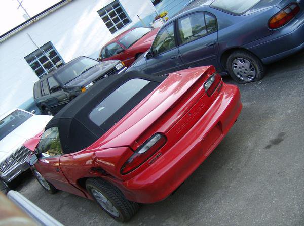

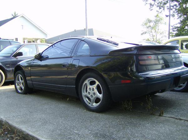

  10. Like Dr. Nic says on The Simpsons, "Hi Everybody!" My V8 Z project has begun. This is way over my head skill-wise, so I am having the work professionally done. The LT1 is out of the donor 94 Camaro, and the machine shop is working on the block this week. Here are the parts I have purchased so far for the engine: 383 Stroker Kit Trick Flow 195cc Heads GM Hot Cam Electric water pump (may not fit) Transmission will be the six-speed automatic out of the Camaro. Mechanic said he would upgade the internals of the tranny to hold the extra power. My mechanic is talking 500rwhp after we upgrade the LT1 fuel delivery by replacing the fuel rails and adding a couple pressure regulators. He also has a complete rear-end that I am going to buy from him used. It's straight-axle, but he says it won't kill my handling. Somthing about "ladder-bar, triangulate, coilovers, and Nascar" if that makes any sense. You can see my lack of knowledge showing, so bear with me. My dilemma is that I would like to eventually leave the door open for forced induction, turbo or blower that would get me into the 700 rwhp range. I have looked at the rear-mount twin turbo kit for the LT1, which I like because at least I don't have to worry about space under the hood. I also looked at the T-76 single turbo and a Vortech supercharger. I am guessing that neither of these two will fit under the stock hood, which means I would lose at least the sleeper appearance of the car. I would appreciate any advice in regard to ways to get the car on the road now NA, while keeping it as easy as possible to add turbo or supercharging later, as well as input on the specific setup to choose later. I will upgrade to forged internals when I add forced induction. Thanks for your help!
