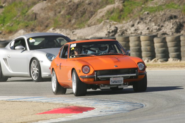

  6. Just got back from Laguna Seca. I raced with "hooked on driving" club. I have never been on the track before. I brough my 2JZ-GTE 240Z out of hibernation. 402 HP at the wheels 2800 lbs (she is big boned). I had a coach all day and learned alot. I could not believe how fast we went. I was sweating and had a dry mouth. It take a while to get used to drive so fast. Unlike the street your line is not determined by the line painter, but your will. Hitting the rumble strips put a smile on my face. The car stuck like glue with victor race 700s on it, only once did the back start to slide a little. I have new respect for race drivers. It is takes huge nerve to keep the power down on Laguna's straight. I had good power so I could pull on the 911 Turbos, GT3, and Skyline on the straight, But they had better corner speed. Awesome day. I worked for 5 weeks to get the car ready. I only had 4 hours of sleep the night before. When I got home, I went to bed at 7pm I was so tired.

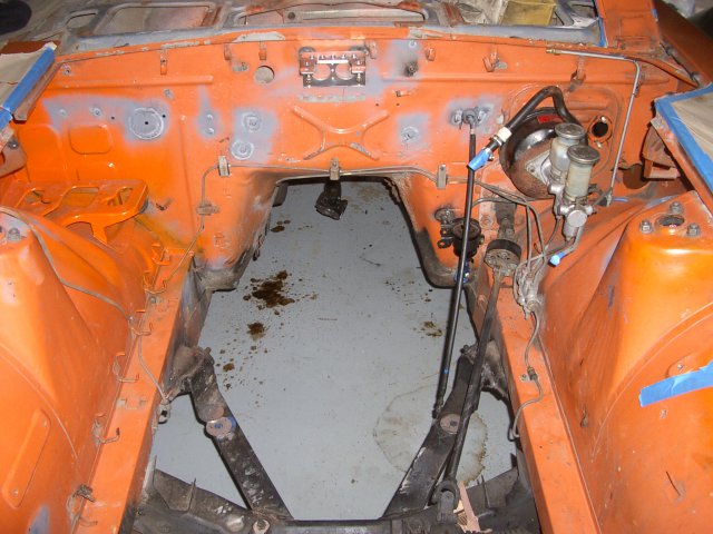

  7. Update; The fronts are cobra 2002 The rears are C4 corvette 1996 I installed a 280Z brake booster. It required drilling new holes in the firewall. It is 8.5" in diameter. I just clears the clutch MC. I drove the car with the same HPS pads. It is a beast. Stops right NOW. Good feel. It looks like aggressive pads are not required with this booster. That said I understand that aggressive pads would make this setup even better. I cannot emphasize enough how much difference the booster makes. Cheers, Cyrus
  8. Will a 260z 7 1/2" brake booster bolt in a 1972 240z? I heard there are 4 to 6 different models. I want to clear my clutch MC and bolt in. So I figured a 1973 booster would be best.

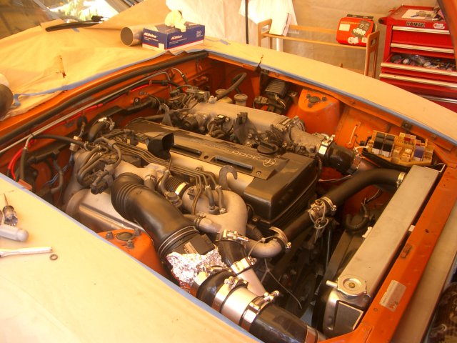

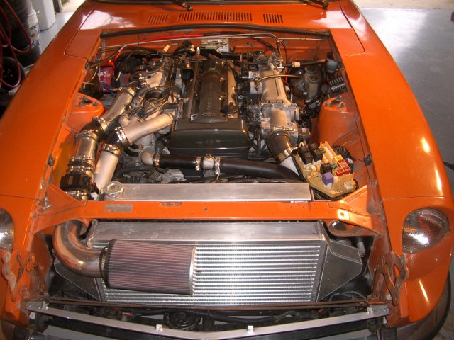

  10. More pics to catch up. put aabout 30 hours into it. So much more refined. Its all in the details!
