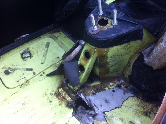

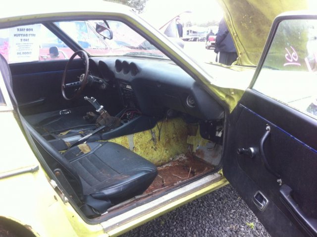

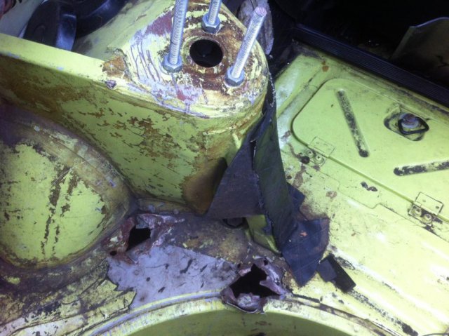

  1. Rust can be hard thing to stop entirely. You can slow it down, but unless you take pretty much all the pieces (welded ones as well) off and remove the rust, there will always be some there. Since you plan on doing new frame rails anyways, get what you can with whatever tools you're able to get. Remove as much rust as possible and get something like Rust Mort if you can find it. It brushes on and you wipe it the next day with a wet rag, then blow off the water with an air nozzle. If you can't find that, there's spray paints out there that are designed to go over rusty areas (but not scale). I'm not talking about Rustoleum or any of that - that'll help a little, but not much. Go to an automotive paint supply store and see what they can find for you. ...and if your rails are this bad, I wouldn't want to be driving much in the next year. No doubt not having a bottom to your frame rail will affect the structural integrity of the car. Good luck.

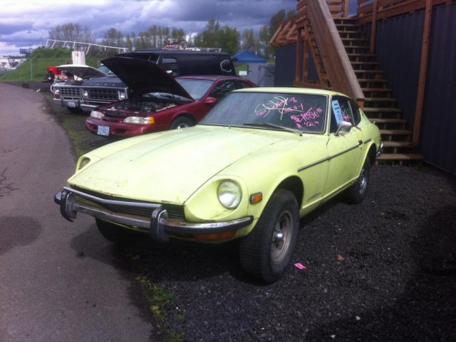

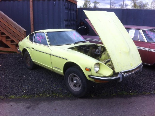

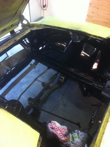

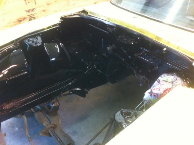

  4. Hey all. Hoping that this is the right part of the forums to post this sorta stuff in. Anyways, I picked up a '73 Z about a month ago at the Portland Swap Meet for a steal. It had some of the parts for a V8 conversion, which is what initially sold me (as that's what I wanted to do eventually anyhow). Come to find out it was missing some key pieces...motor mount setbacks being one of them. Found another kit on craigslist and picked it up. Golden. The body is in pretty decent condition considering what I've seen when looking at other Z's for sale. Little rust, some hackjob metal work, but nothing I can't repair. I build hot rods for a living, so welding's no big thing. Brakes seem firm, as does steering. I'll cut to the chase. I've searched, read FAQs, and would've ordered by now if Tokico wasn't having issues. I have questions - but first, my plan. Chevy v6 out of a '94 pickup (father-in-law's - free!) with 200r4 trans. Energy Suspension bushing set ST sway bars front and rear I WAS going to get that Tokico HP kit that's everywhere on the internets, but alas. My questions: Does this seem like a reasonable set up for a 98% street car? I have no plans to race or drag. Just want a driver that's got good, solid handling. Since Tokico's a ways out, and I want to be on the road ASAP, what's another decent substitute? I don't think I need coilovers, and am a bit nervous about sleeving a brand new set of shocks. I was thinking KYB Gas-a-Just. Any thoughts and opinions are helpful. It seems like a lot of you guys set your cars up for the track, so it's hard to find info with a swap AND having it be a street car. Don't worry, I'll keep searching and reading. I've got my flamesuit on anyways.
