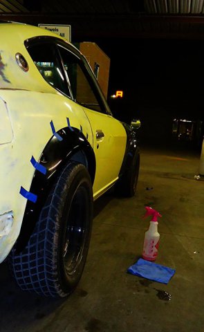

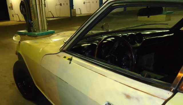

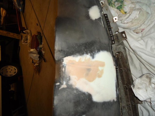

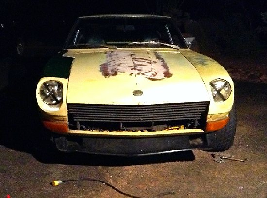

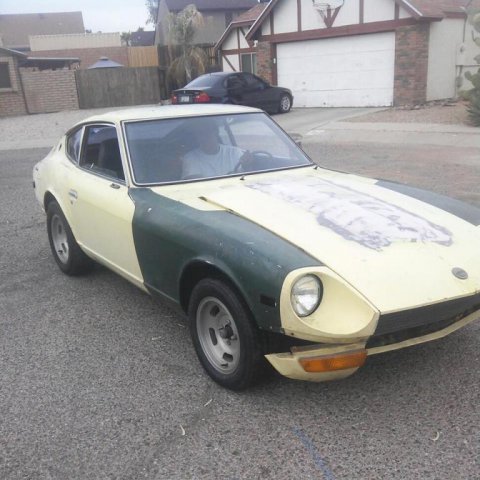

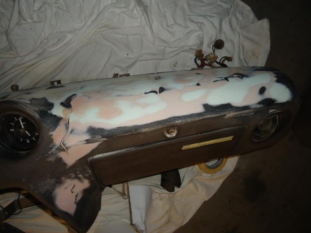

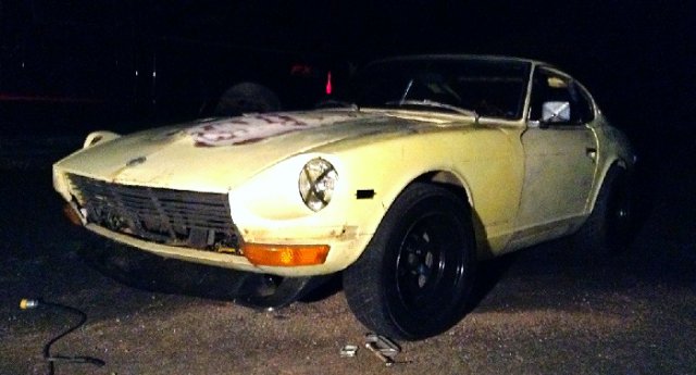

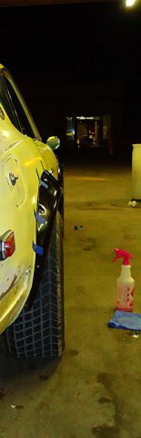

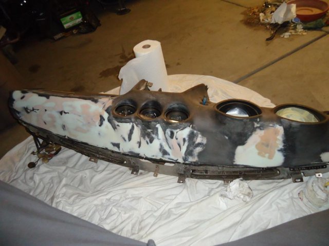

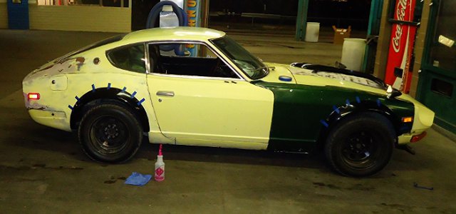

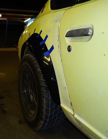

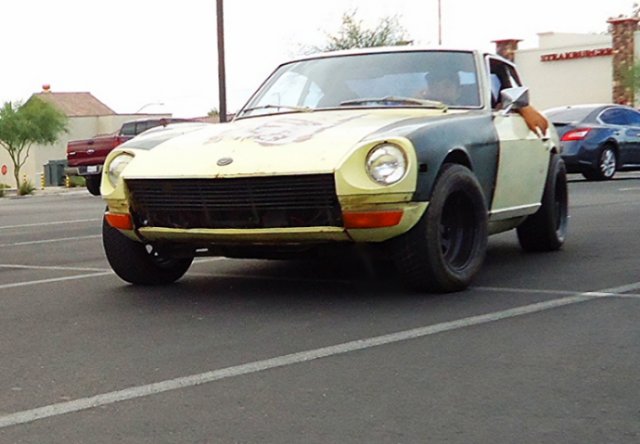

	Just wanted to make a quick update on the z!!! First i finally got my BRE spook/ airdam installed. I love how much more agressive it makes the car look. Next I repaired the cracked dash and got it back in the car. It was a fun little project Cut all the crack "moutains" level and did a quick bondo job... yea i know its cheap but im a broke single dad haha. So it will have to do till I save enough for a new one haha. Came out pretty decent looking. Also got my fender mirrors mounted on the fenders!!! Damaged my airdam but I gave it some stitches and it looks a lil tougher imo lol. This is how the vehicle currently sits. I put back on the driver fender cause the fiberglass one wouldnt line up flush with the door. and these are a couple pics of my flares mocked up ... I think they are just right! Install and cutting will begin in the morning. Any tips on the install would be awesome. Have a good one Hybrid Zers!

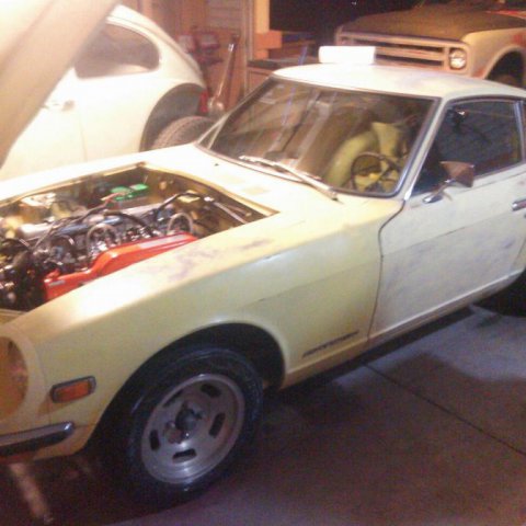

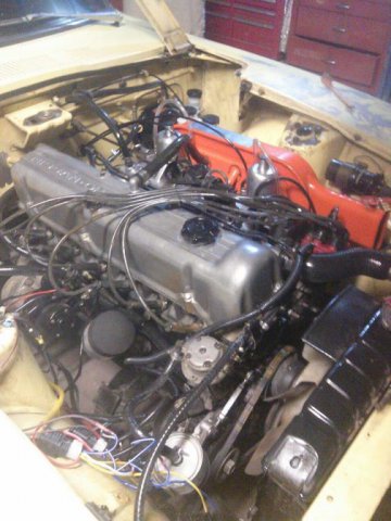

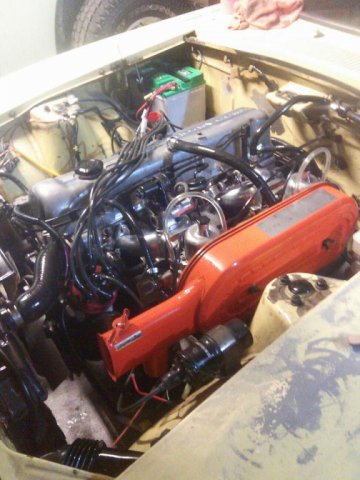

	Hi everybody on HybridZ! I picked up my first Datsun about 3 months ago. It was in pretty bad shape, not running, and the interior was completely gutted. I Talked the seller down and got it for $1300 cash. . The motor is an L28e and it also has a 5 speed swap. It has SU carbs on her. I had to clean and balance them, clean the fuel tank and the dizzy shaft was installed 180 out. Got all that fixed and she started right up with a little fuel in the carbs. Suspension was done and would bottom out on a regular so I put some used, but much better, struts on her. The body is rust free and fairly straight with the excetion of the roof, a fender and the hood. Nothing a lil bit of elbow grease and some TLC wont take care of. Ive slowly been going through her replacing wat needs to be and re filling her with fresh fluids. Replaced the clutch kit, starter, spark plugs & wires, dizzy cap, K&N filter, 20w oil in the carbs, ngk copper plugs, new oil pan gasket and valve cover gasket, brake pads, bleeder screws, motor and transmission mounts, and bushings. With what little work ive done on her she has come back to life. it ran ok when i first got her up but now its like a totally different car and is so much more responsive! The brakes were a little tought at first but with a fresh bleeding of the system they came back. The car also would not go into gear so i had to adjust the clutch and it shifts smoothly now! It came with almost all its badging and the dash which was removed and cracked like crazy. I sanded down the "mountains" that the cracks had formed and leveled it off as best i could. did some bondo work on it and now i have a smooth dash that is at least presentable lol! Rattle canned the dash black, looks pretty good IMO. the wiring on the vehicle looked like a rat nest so i just took everything out rewired it myself and now i have my home made harness that works and didnt take long to make . I still have a decent amount of wiring left to do though. The tires were bald and had slow leaks to i had to replace em. I just picked up a set of wheels with tires and got a great deal on em so i threw it on some racing steelies. Looks nice and a little bit aggresive at the same time ! My plans for the vehicle as of now are to get my flares installed, my BRE air dam, and get a wing aswell. Coil overs, paint, interior, racing seats, carbon fiber hood, oil and tranny cooler installed and mounted. motor wise i just want a mild build. My goal is anything near 200-250hp to the wheels. I was thinking upgrade carbs, cam, pistons, valve train, headers, intake mani, dizzy and msd ignition. Any help or advice would be GREATLY appreciated! ... Now for some pics. This was the day i brought her home. started cleaning her up cause she was really dirty Here is the motor after I got it cleaned and polished up as best i could. You can see the wiring headache I had to deal with. Installed the straight fenders. Here it is with the new wheels. Bart racing steelies, 14x8. offset unkown As she sits now. I will upload some pics of the interior and with the air dam installed asap. Will update as often as I put work into her. Thanks for looking and have good one HybridZers!!!
	Thanks for the info guys. I got a FSM finally and that the reason i was able to start it. Im not too sure which dizzy im using. Ill look it up and try to figure it out. Wick Humble book has been ordered, very excited to get it. Now its time to post my car. Thank you guys for all the info and I really appreciate the literature your sharing with me. This is by far the best z forum with the quickest and most informed replies!
	ok so she is running and running great ... until i drive her for a while ... then she start to have a lack of power and hesitates when i first hit the gas... im thinking my coil pack is going... just wanted to see if u guys thought the same ... any and all input is greatly appreciated!!! thanks in advance
	THANKS TO DADDYDONUTS!!!! I got her running and back on the road... appaerantly the guy whom i purchased the z off had the shaft for the dizzy installed 180 and he had it running like that when i bought it lol... got it all back to normal and got to adjust everything in there to spec.... now shes running like a top... just sounds like she need a lil more gas on idle... thanks you guys for your thoughts and input.... i really appreciate it!!! this forum kicks A$$! good day
