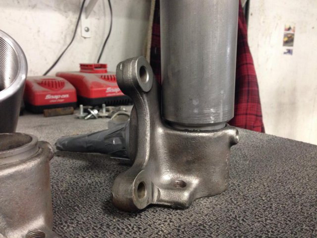

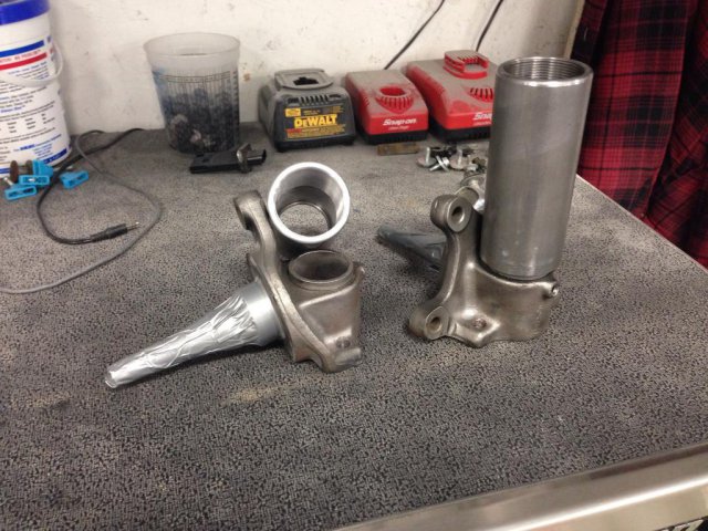

  3. Just thought I'd show you guys what I got welded up today, I'm pretty excited! Can't wait to have this thing on the ground! I have more of these tubes. I have 6 sets up for sale. 54mm x 2.00 thread. I'll post some more pictures tomorrow.
  4. I think I've seen this same thread on ZDriver. I'm planning on copying it, hope that doesn't upset to many of you! These brackets are the final piece I need to get my car back on the ground. If someone gets a kit made up in the near future I'd be more than happy to buy one, but I'm just too impatient. I know there is enough demand for these so if I get one put together, I'll have more made up.

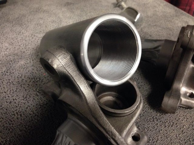

  5. The tubes I have are already have CNC cut threads.
  6. I have conformation that the tubes are M54x2.00.

  9. These won't work for the rear. These are just fronts. Let me verify the threads because there either M54 or M55, I know they are a 2.00 pitch. The tubes are 6" long.

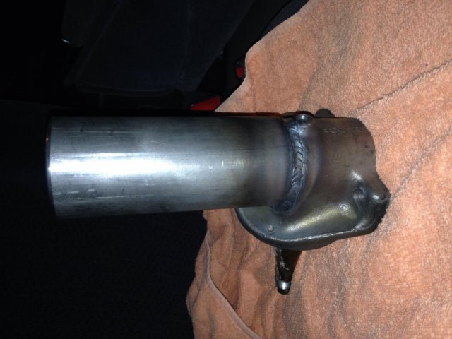

  12. I've got 6 sets. I believe they are M54x2.00. I've got T3 coilovers going in my 280zx. The tubes are press fit onto the spindles and then will need welding. I'm having mine welded today, hopefully will have pictures for you soon. I will verify the threads and let you know ASAP.
