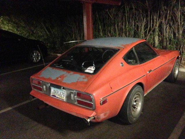

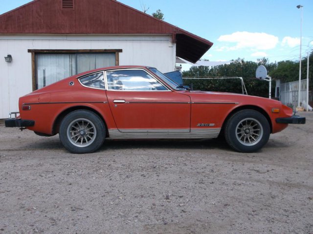

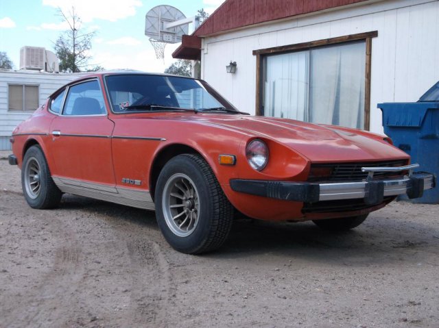

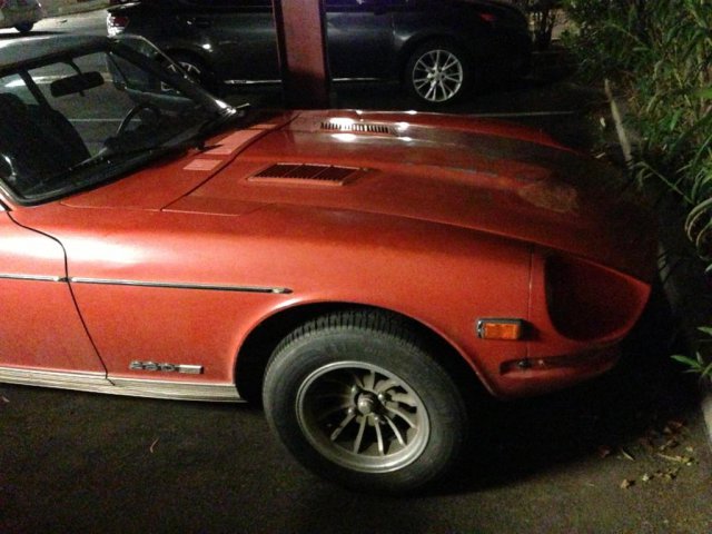

After months of dreaming about a Z I finally bought one today. 1978 280z. 5 speed. N42 head. Fuel injected. Problems: Cracked dash. Needs seals around doors and windows. When you shift hard it sounds like the differential bangs. It sways like a boat on the freeway haha. Upholstery needs to be done. Pros: 25mpg! not bad, I was surprised. Starts up quick. Plans: Sell my G35. Upgrade to P90 head, valve job, any other ideas? Build the block, not sure exactly what but maybe bearings and a light bore. Ideas? Fix suspension.
