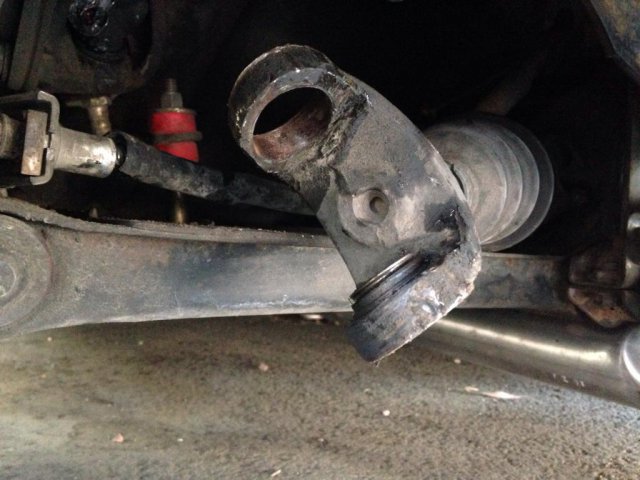

NewZed, Yea I just picked up a halfshaft today. Im going to put it on and hope it doesn't happen again. If it does i'll start looking at alternatives. Rz, I saw the pics you posted, it just sheared off. I guess time will tell for the both of us ha. Im running 225's on 15 x 10's. I thought that all of that extra grip could be adding a lot of additional stress. Who knows. which clsd are you running?

I had actually replaced all four of them three months ago. They were new. I did about a total of four launches from zero within that time frame. Mostly I would go hard on the throttle from a roll. I just picked one up today that I'm going to slap on so I can get back on the road. My car sits pretty low, the lower control arm is pretty much straight, it doesn't angle down. What do you mean by a stock axle not binding? You don't think it can bottom out if the car is low enough? I started to think that it could have been that because the u-joint didn't just snap off cleanly. The eyelet of the half shaft was also twisted. I though that since the car is low maybe it bottomed out...... Do you think I should shorten them just to be sure? Should I convert to cv axles instead? I know that I can run the 280zx or the 300 zx cv's but which one would require less modifications. I saw that they have adapters that bolt up to the stock 4 bolt flange on both sides and them bolt up to the 6 bolt cv axle.

Hey Rebekah, I was rolling in first and then hit the throttle and went to second and it snapped the u joint. I was wondering if it could have been a weak u joint. I'm not sure. Some people say it's better to stick with solid u joints. As of now I'm looking for a replacement half shaft. My plans are to get a clsd r200 and switch to cv axles. I would like to switch to cv first and then get the clsd. I've seen some peoples threads about the conversion but didn't see anything about cost. My car is also lowered but not extreme. I wonder if I had a binding issue. I'm at a loss. Not sure where to go from here.

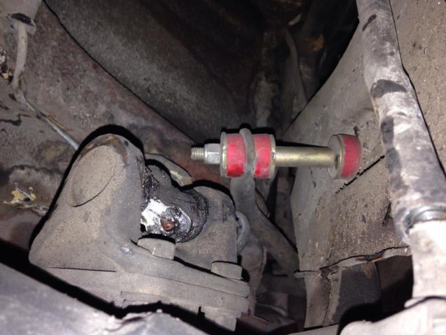

I recently broke a half shaft on my 78 280z. Stock l28et with a tune. 10lbs of boost. 211hp and 240tq. It broke the day after I had it tuned. It banged up my brake line a bit but it's an easy switch. I don't understand why some people are saying that a broken diff is better than a halfshaft.....what am I missing? My u-joint snapped and the ear in the half shaft was twisted. Could this be a u-joint failure? It was a greaseable u-joint with the hollow center. Would I be better off purchasing solid ones? I'm not making nearly as much power as many others and I'm trying to understand why it snapped.

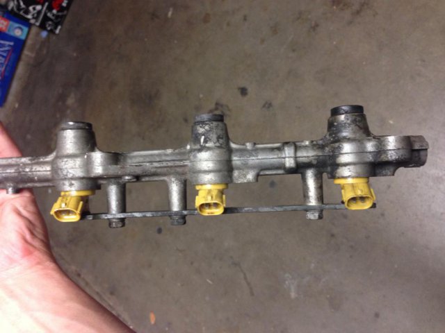

That's what I'm thinking. I'll talk to the shop that did the swap. I'll see if they offer non-grease-able ones. I know someone that is giving me what he called side mount supra injectors, don't know if they are high or low impedance, from a 1jz. I believe it's an early 90's engine. They are o-ring style injectors, any idea if I can run these? Or any advice on the easiest injector swap. I know there are a couple thread that discuss injectors but i havnt found one that states how you change them out. I I don't know if people usually get an aftermarket fuel rail that is set up for o ring style injectors or a fuel rail that connects to the injectors with hoses like the Stock one does. Any advice?
Hey Seattle, Not at all. I probably did 4 launches in the 2 months of getting u joints and not a single launch from the moment I got it tuned. Just a couple first and second gear pulls from a roll. I dont want to do a crazy costly conversion. I don't even mind keeping the 280z half shafts. I just need to find really strong u joints or something. I did some reading and this has happened to multiple people.
Well the happiness was short lived. The left ujoint snapped and the half shaft where the ujoint is inserted twisted. They were new and were supposed to be the strong ones. Anyone swap their halts shafts for aftermarket?

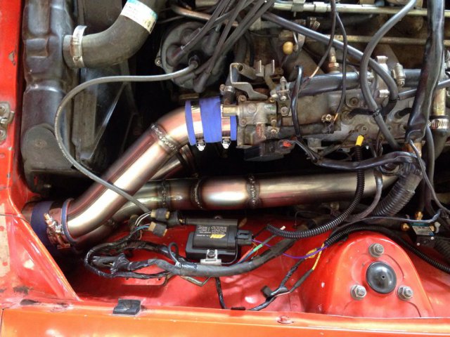

Engine: stock l28et from 83 zx Turbo: Stock Intercooler: pulled from a SAAB Ecu: Megasquirt 2 Fuel: stock Exhaust: 3in straight pipe Boost: 10 lbs 211hp / 240tq
Just a Little update. I got the MS2 installed and had the car tuned. Everything is stock except I added an intercooler I pulled from a SAAB. The injectors maxed out at 10lbs. It did 211hp and 240tq. Next step will be getting larger injectors and probably the KA throttle body. I'm really happy with the numbers. It feels really strong when it pulls.
