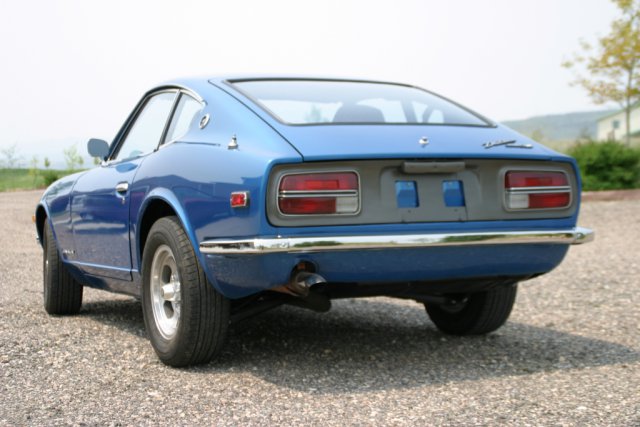

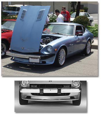

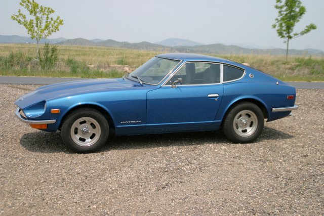

  14. Hi guys! Im just thinking out my paint/rim scheme and was just wondering what you guys think : ) Planning on painting my '77 280z in a 903 Blue 240z colour with RAYS GT-C 17x7 rims in silver. Also planning on shaving the rear and going for a 240z frontbumper with an aftermarket air dam from Motorsport Auto. Could this be pulled off in the right way you think? Or should i go a different direction? Thanks for all your opinions, and i'll trow in some pics of the different ideas

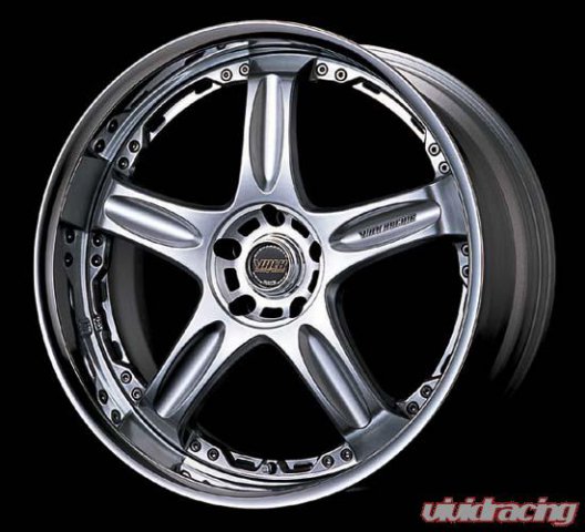

  15. What offset would you recommend? But i am also thinking of some other rims, maybe the Watanabe's, König Rewind or some other one's. Feel free to help me make a choice
  16. Yeah sorry, forgot that! It's gonna go on a S30, with the size of either 16x7 or 17x7.5 with 40 offset.
