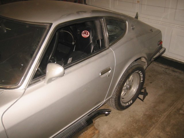

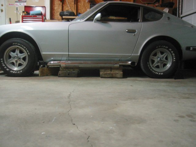

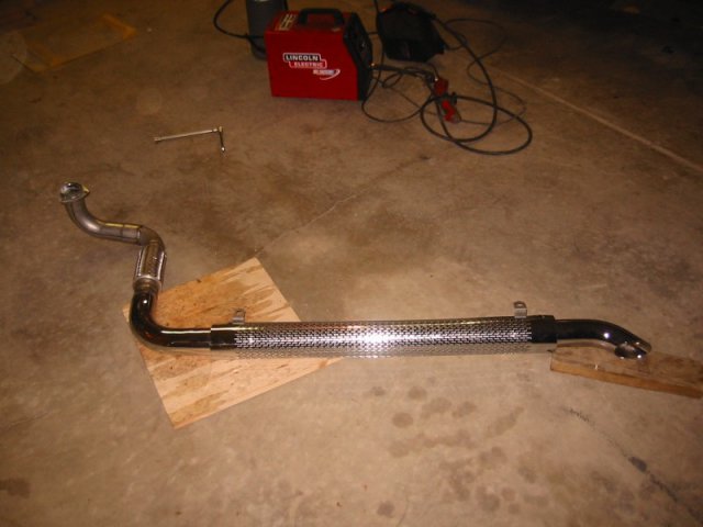

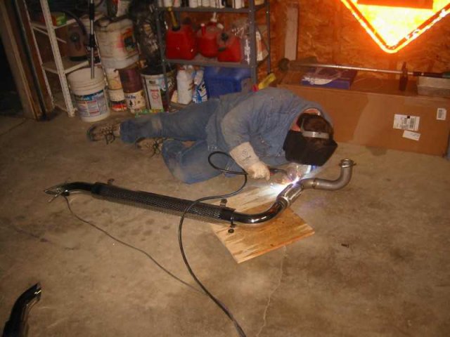

Just finished the final install and... wow, I was (am) very pleased with how these sound. I got a feeling what little fiberglass I left in the muffler isn't going to last very long. Just blipping the throttle in nuetral blasted all sorts of fiberglass material out of the tailpipe. Oh... darn!!! After tacking everything in place I had my friend "big Jer" stop by and finish the welding job. He also helped lift the pipes in place and bolted them in. Even suckered him into doing collectors. Hehe... I would have shot a short video with sound. However, the camera battery was on its last millivolt and my new rubber valve cover gasket is already leaking. Gotta love SBC valve covers. Anyway, here are a few pictures: -

Update after last night: Well, the pipes are now securing fastened to the car. However, the more I look at my setup, and the more I look at “Coze Z Cole’s” setup, the more I think I need a flex piece between the pipe and header. Gonna try to shop around today and see if anybody locally (Detroit area) has a 2.5” flex piece. If not, I’m sure Summit sells them. As for the mounting, I basically took half of the Dynomax brackets and threw them in the garbage. I wound up keeping the rounded section of the clamps and used those to connect the heat shield to the muffler section. I had to cut off the threaded section of the clamp so just the raw rounded metal section of the U-shaped clamp was left. First, I welded one of these pieces to each end of the muffler pipe. Next, I took the heat shield and placed it over the muffler section with the U-clamps provided a good ½ inch spacing between the two. I started welding one edge of the heat shield to the U-clamp on both ends of the pipe. Then, I had a fairly burly friend squeeze the heat shield and hold it in place against the other end of the U-clamp as I welded it in place. With the muffler section and heat shield now permanently connected as one, I took to hanging the pipe from the car. I drilled holes for the front and rear hangers and installed the Dynomax supplied hangers and rubber isolators. Instead of the cheap shiiit metal screws, I used thru bolts and fender washers. After all, these Datsun floor boards aren’t known for the superior thickness. Anyway, I then held the pipes in place then welded the hanging section of the bracket to the side of the pipe. Overall, it came out a lot better than I had originally expected. It is impossible to see any of the mounting hardware from outside the car. There is maybe a 1/4 inch gap between the top of the heat shield and the rocker panel. Even go, the gap is outwards and not hanging down. While I would have still preferred to hang the pipes along the rocker panels, it just wasn’t going to happen with what I had. I’m pretty happy with what I came with instead. I would have tried to finish more last night, but it was already 11:30 PM by the time I made it this far, and the Wings just tied it up in the second period. Still need to finish up the two bends coming off the header and insert a flex piece. Once that is done, she should be ready to fire. I’ll hopefully be able to post up pictures and a video clip when it’s all done. -

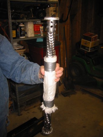

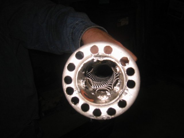

After discovering that the Patriot sidepipes had an ultra restrictive inner diameter of 1 and 5/8th inch in the muffler section, I ordered the ($100 more expensive) Dynomax kit that advertises a 2.5" inner diameter. Nope, they lied. The Dynomax muffler is just as poopy as the Patroit. However, the Dynomax muffler section easily slides out of the 3 inch exhaust pipe it is housed in. After sliding the muffler piece out, I drilled about ten 1/4 inch holes on both sides of the retaining ring and removed all the fiberglass. Not sure how loud this will be, but it's got to flow at least a little better now. Earlier tonight I heard a 350 SBC with the Patroit side pipes at a local car show. I was pretty bummed at how quiet his setup was. Hopefully my "cutsomization" of the muffler inserts will wake it up some. If all goes well, I plan to have this wrapped up by next week some time.
