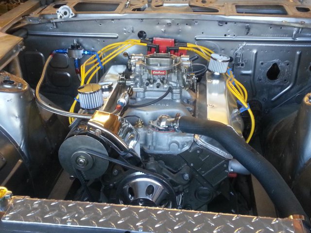

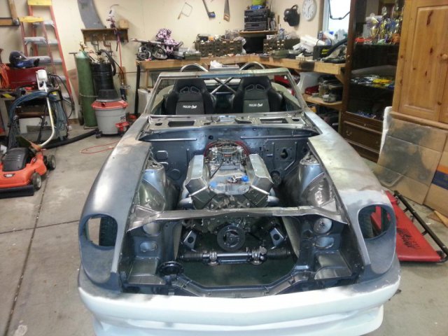

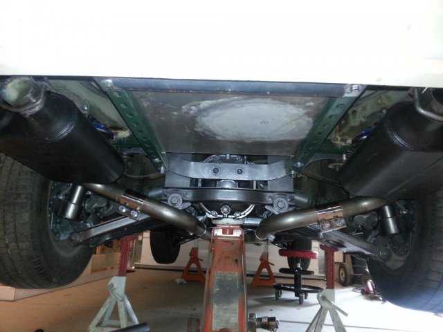

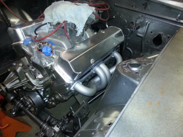

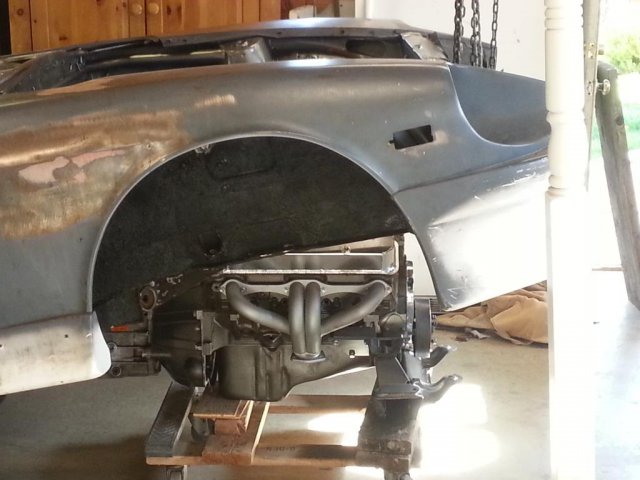

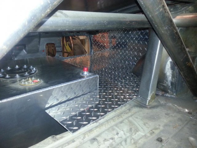

These are recent pix of my motor plumbed and nearly ready to fire . Also a a pic of the rear of the car during fuel cell install and diamond plate .

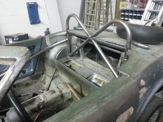

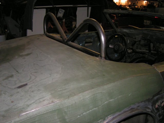

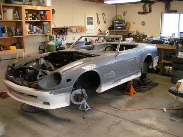

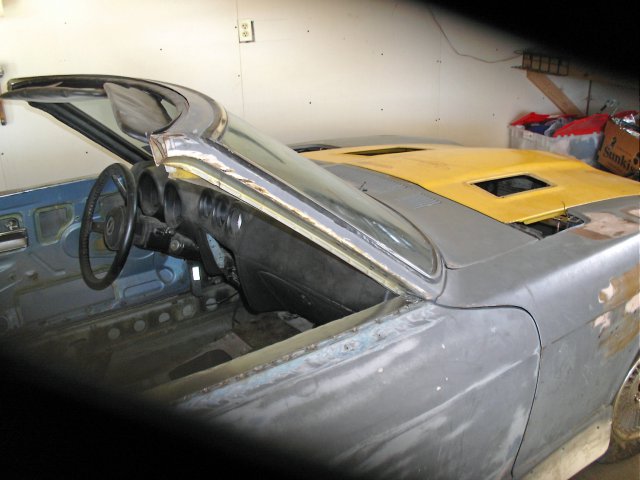

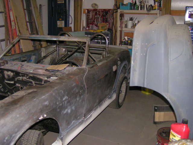

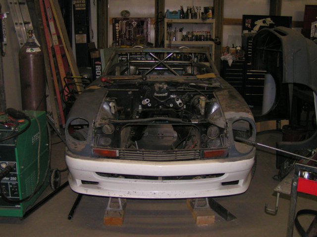

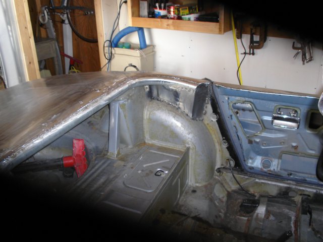

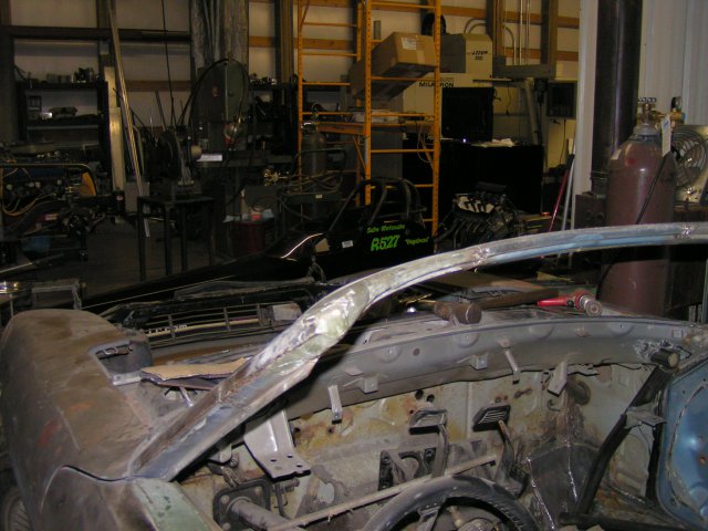

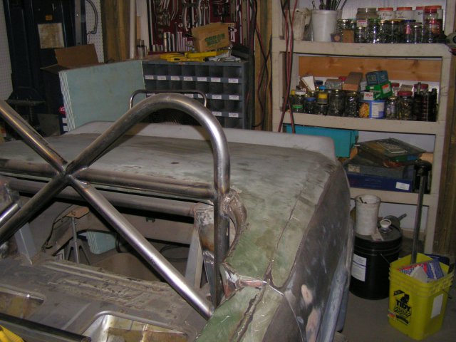

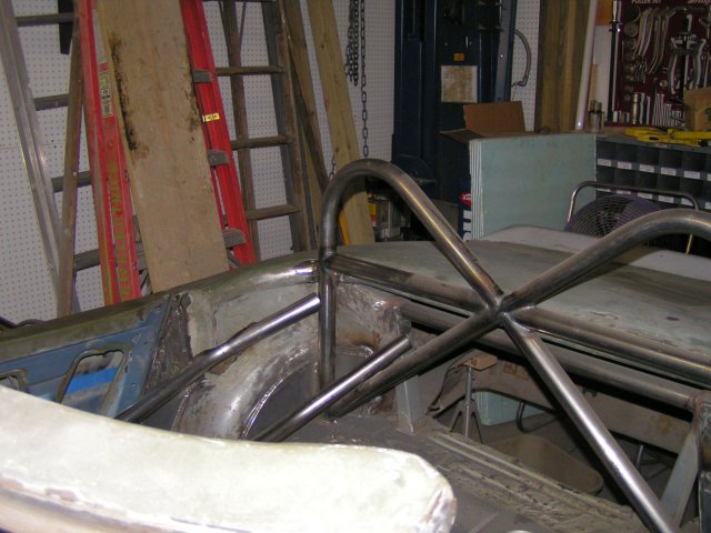

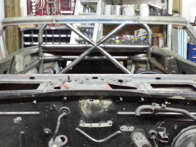

Sorry no pix of the early part but I can show you in detail where to cut yours and if you are feeling rather lucky some where I saw one with a working trunk , I have some ideas of how to do this . And yes I will be doing something about the frame but at a cost of interior look . My solution is to build a roll cage tha basically connects the 4 strut towers together as one big box (a removable strut bar connects the front) with an x brace running thru the doors from front to back. In my new pix you can see how the wind sheild was cut .The new one is chopped down a further 4 " Learned how to do that after the glass guy succeeded at cutting the glass. had to section the wind sheild frame by cutting the frame in 3 places and welding in a piece from a donor car which I might add got some good looks as two white guys cut a 6" x 20 " strip out of the wind shield frame of the donor car at the junk yard again with the now infamous sawz em all. I figure any way why not it has z right in the name......

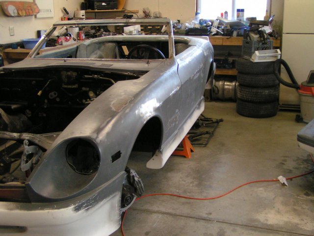

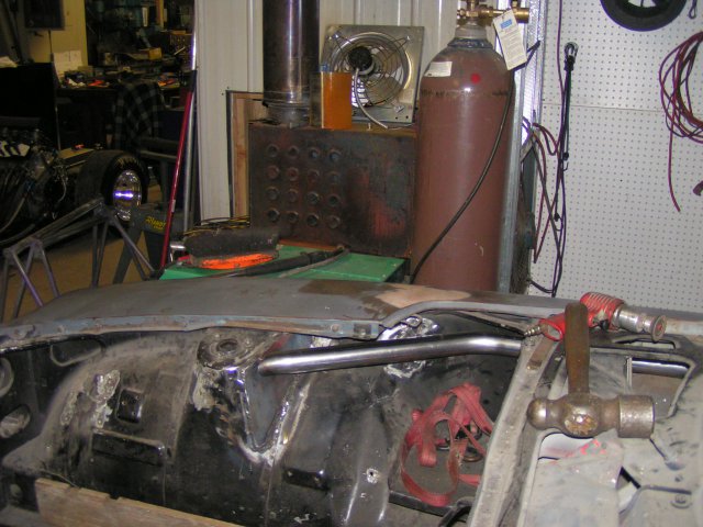

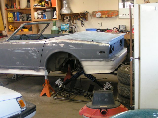

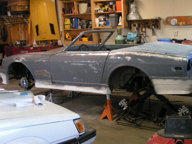

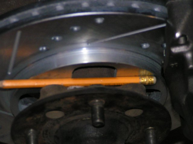

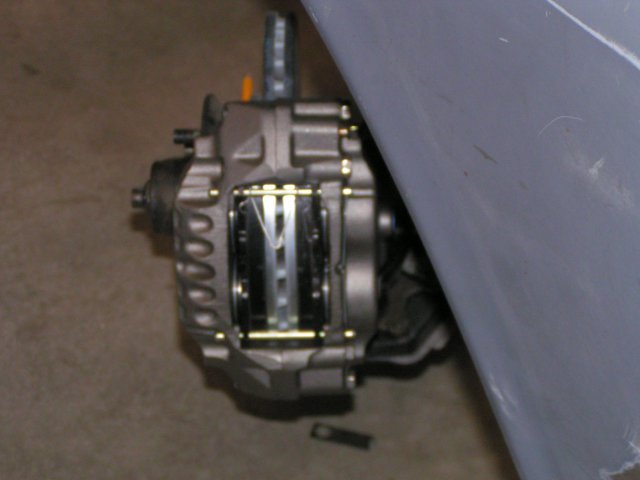

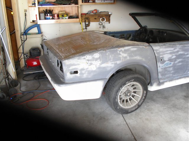

A little history ,this car started out as an almost finshed project . Curse the inventor of affordable sawzalls and cheap beer . ( not a good combo ) Let me add that at the time I had zero auto body exp. This is what I learned , The rear hatch has basically the right curve to match the body lines from the strut towers back . This is where I learned my first true auto body term (other than bondo) sectioning .I " sectioned " the rear hatch to fit from about an inch forward of the strut bolts. The radiused areas are actually 2" emt pipe I over laid that with sheet metal which I used hammers and dollies to shape the edges. ( more I learned ) .Another unfortunate thing I did learn also was a term welding sequence. Then I got to learn about metal shrinking ,and how to do it So any how or more like some how I got it to this point . Right now I am working to finish the brakes and suspension , and am clearing out the engine bay for my 350tpi motor . The suspension is all msa the brakes came via ebay (the backs fit purfecto the front require some reworking of the spacers.
