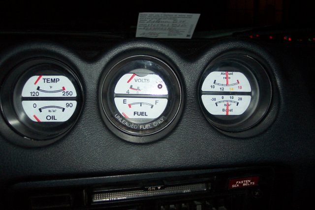

I agree the needle gauge is not good for tuning and I only use for monitoring. I tune using the wideband reading from the ECU. I only made the gauge because I wanted a 100% stock looking interior and was not going to have a wideband and boost gauge stuffed somewhere. I have smoothed out the gauge and its actually not that bad to read. You can tell if its 11.0:1 or 11:5:1 but thats as close as you get. When I get my new driveshaft I'll take a new video with the camera mounted in the car so you can see how well it works. I plan on making a new gauge face for it as the needles actual sweep further than I thought and I'm losing resolution. The 10K tach is for my RB26. Russ

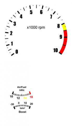

Yes, I took the stock tach and marked every 1000 rpm from 0 to 10000. Then scanned in the stock face and made my new one using the marks for reference. The stock tach is by no means linear. Here is how my calibration turned out after I adjusted it to 10000. I used these values to make my new gauge face. Actual RPM Measured vs. RPM on stock gauge 1000 750 2000 1500 3000 2250 4000 3000 5000 3900 6000 4675 7000 5500 8000 6350 9000 7100 10000 8000 I can upload the Adobe Illustrator file if someone has somewhere to host it. Its about 150megs but it includes the cut lines you'll need for the graphics place. Russ
The 10K was easy... I just adjusted the screw on the back until it read 8000 when being fed a 10K signal. Then I printed a new guage face that was rescaled to 10K. I will post the graphics file when I return next week so that any one who wants a 10K tach can just carry the file to your local grpahics place and have them print and cut one out. The file has the cut lines included. I'll do a write up on making the gauges and the driver circuit for the AFR/Boost gauge. I setup my AFR/boost gauge to receive data from my Electromotive ECU. So its not connected directly to any of the sensors. It would be easy for someone to take my driver circuit and drive it directly from a MAP sensor and wideband unit. Russ

Figured some of you guys would be interested in this. I don't like gauge pods on the A-pillar and wanted an OEM look. So, I took 2 amperage gauges and made my own custom gauge and driver circuit. I need to filter the AFR gauge some more as it jumps around a little. I also reprinted my own gauge face for the tach and recalibrated it to 10000 rpm. I'll take a video of it working and post it also. Russ
