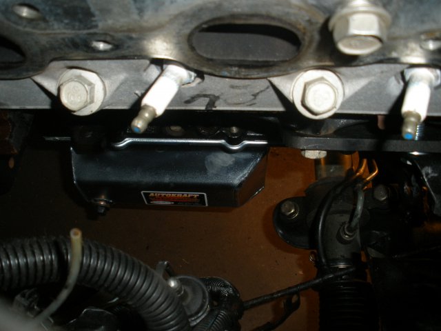

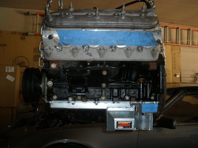

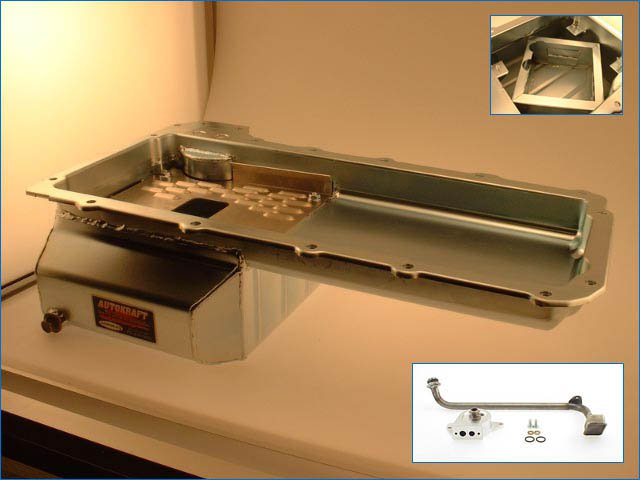

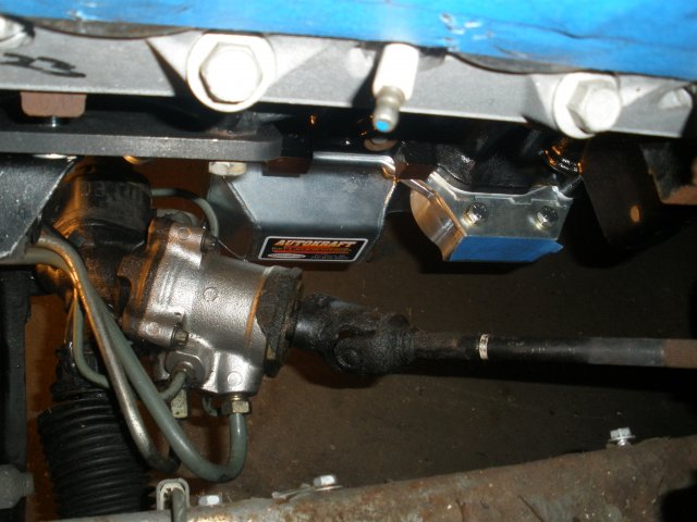

http://www.autokraft.org/products/ It comes with with everything pictured and you'll pay shipping to boot. You'll need an F-body dipstick and tube if you don't already have one. If you have a spacer on your oil pump like I did to use a double roller timing chain, you'll have to slot the mounting hole for the pick up tube since the pump spacer moves it forward a tad. In my opinion it's a pretty good solution. You can make the F-body oil pan work too. To use the F-body pan though you'll need to recess your engine/transmission closer to the firewall or create some clearance between the steering rack and the oil pan some other way.

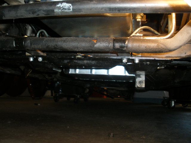

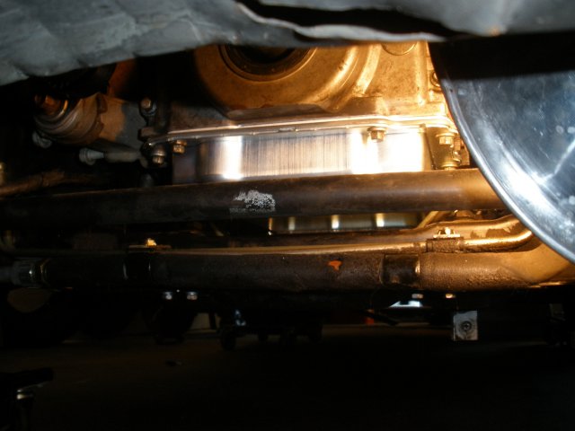

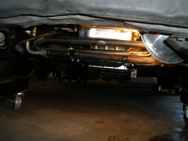

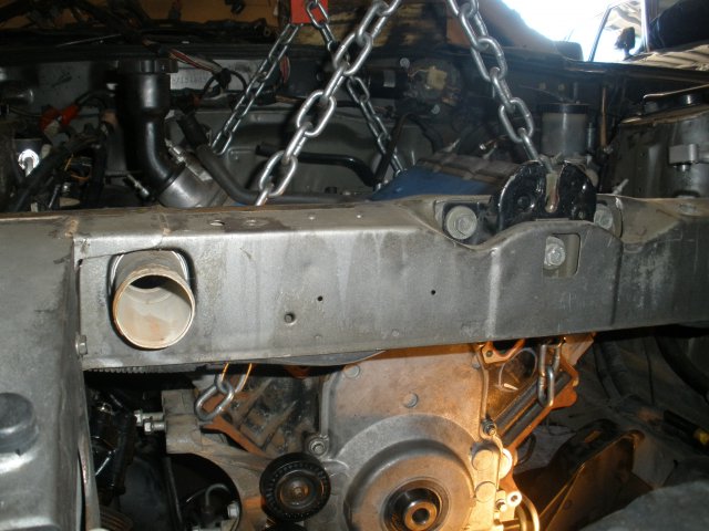

Autokraft rocks. The new Autokraft pan allows the engine to set a little bit lower in the engine bay without the sump hanging lower than the crossmember and that's about it. Can't really move it any further forward than I had it with the truck pan (not that it was going to be used anyway), just saying. It gives PLENTY of space between the pan and the crossmember and if you're brave you could lower the engine even more lowering the sump beyond the crossmember, but I'd save that for a track car. This will be my last mock-up type of update for a while folks since I'm changing what engine set up I'm using in this car. I'll still be using a 6.0L GenIII SBC engine with an Autokraft pan etc. Just going with the GTO eng/trans pullout as mentioned before. I hope this helps some folks!

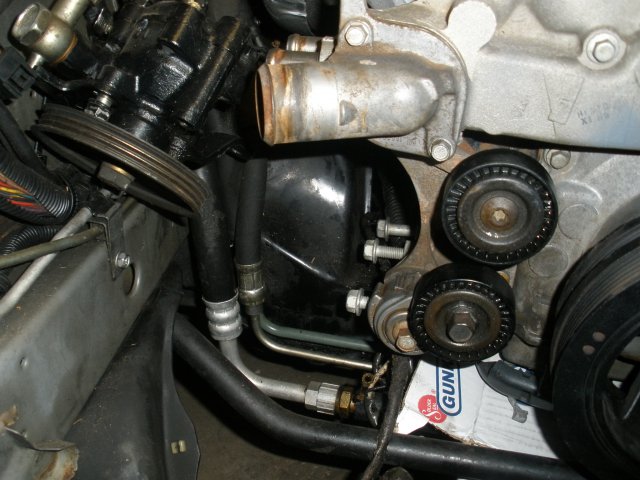

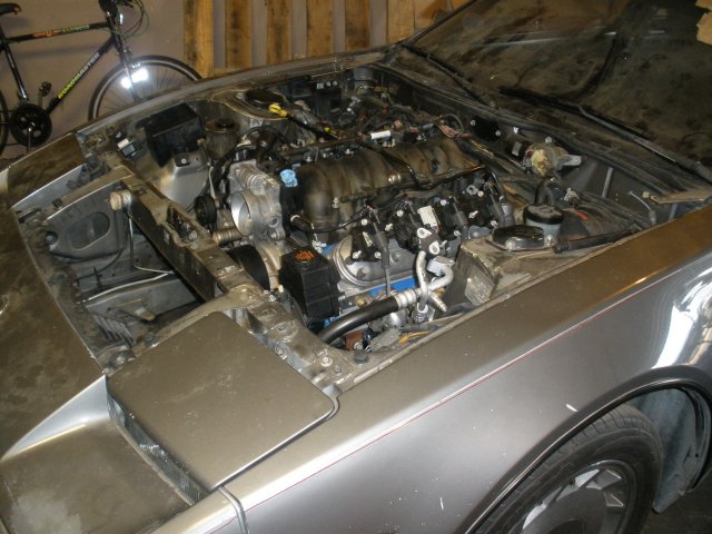

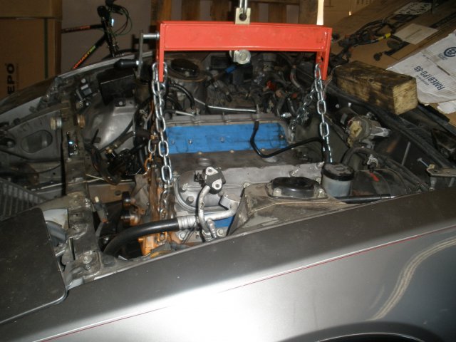

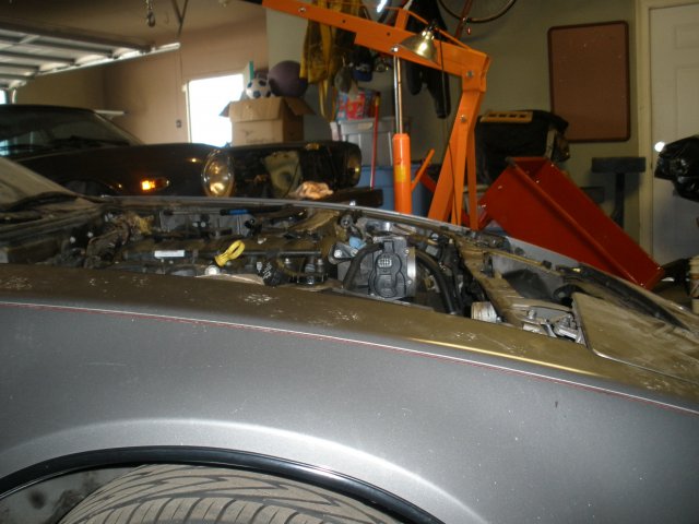

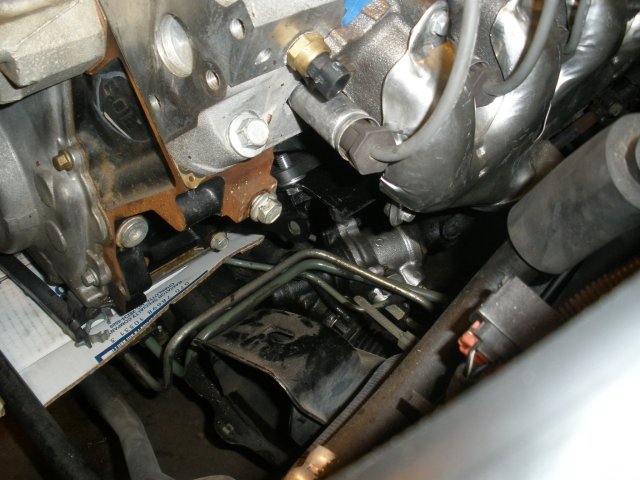

Still waiting on the Autokraft oil pan. I have nothing better to do than mock things up as best I can, so... Here are more pics of the engine pretty much fully dressed with the truck pan on. I have a set of TransDapt engine mounts on the engine, even with the engine setting farther forward the existing driver side chassis engine mount interferes with the alternator location using the Camaro accessory set up, the mount will have to be customized. There appears to be plenty of room for an A/C compressor though. Best part, there is plenty of hood clearance for the TBW! Downside, hoodlatch will have to go
