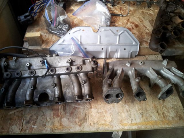

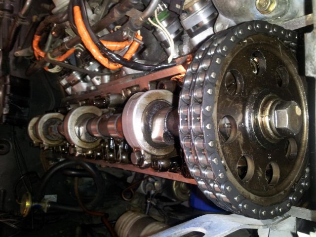

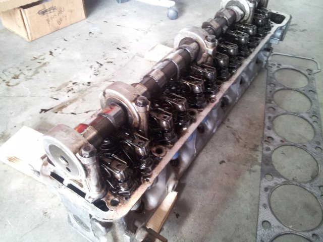

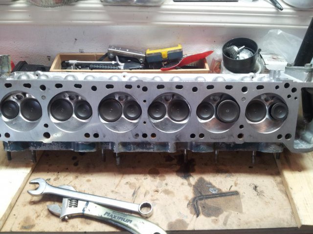

1-TDC with old head 2- stayed with the N47 intake as opposed to the N42 just to keep it "factory". 3-rebuilt head 4-unmolested old head, aka reliable. 5-Felpro kit -

My bad NewZed with the poorly worded questions. The rebuilt head has been shaved to the point where the fire ring on the new gasket sits outside the combustion circumference on the head. I know this will happen with a shaved head, it just seems a little excessive. Thanks for the oiling bar answer, there was a couple of homemade gaskets used before on the bar so I wasn't sure if they were necessary . Here is a list of the head work done. New valve guides Replaced all exhaust valves 3 angle grind with lapping New lash pads Rockers refaced Head shaved 0.004 Cam regrind. Misplace -

Got the head back from the shop. with the regrind cam installed, they shaved .004 off, so no shims, so when I was comparing the old gasket with the rebuilt head, the old gasket would have blocked coolant passages, but never has a issue with the old head/gasket set up. But I overlay the new gasket in the rebuilt head and this head (all passages line up) but I'm guessing the head has been shaved before these guys got their hands on it. The rebuilt head is a N47 head with a oiling bar, it has exhaust liners, but has a block off plate for a carbed fuel pump. The combustion chamber is smaller due t -
