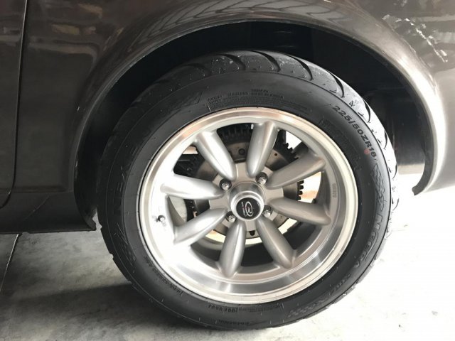

	They are 225/50/15 rear and 205/55/15 front. Nexen Nfera SUR4. Very sticky tire. Hooks up great and corners great for your around town shenanigans. I just looked up more info about the tire. Seems that they are only made in a 225/45 for the 15 inch wheel now. Great. Let me know when you're in town and I'll take you for a spin, not literally I hope. . Panama City, August, No AC, small windows.....bring an extra shirt!

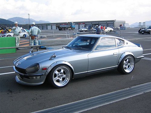

	S30 Air Dam Front Spoiler Options and Builders- 2017 update!LS3Z replied to LS3Z's topic in Body Kits & Paint If anyone can tell me how I can get my hands on this air dam, I would be eternally grateful. My favorite that I have seen thus far. Judging by the super safe and proudly worn jumpsuits and PPE, I am guessing that this picture was taken in Japan.

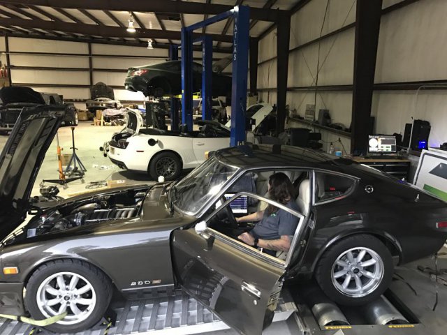

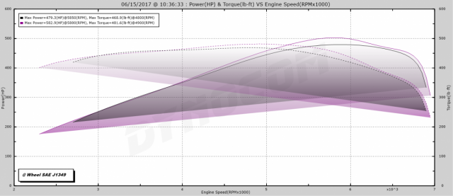

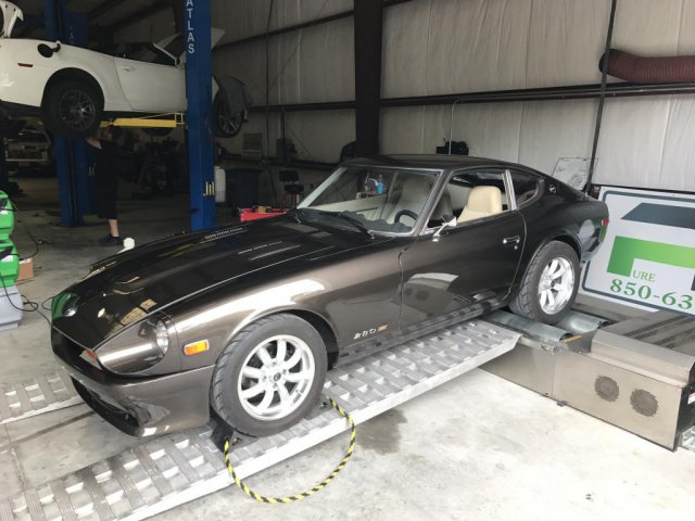

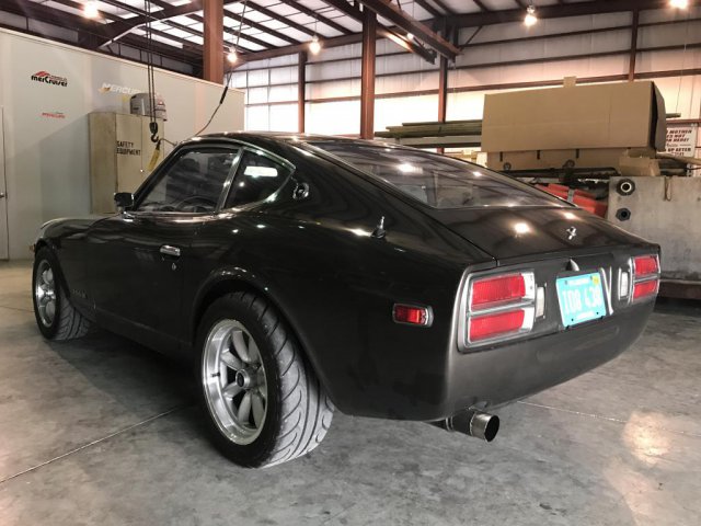

	Hi Hybridz. After waiting patiently for months on end for the right 240/260/280 to pop up for sale, I recently picked up this beast of a 280 with a 2015 LS3 setup. She still has quite a few things to finish up, but most of the hard work is already done.. One item that had yet to be completed was engine tuning after cam/Springs/trunions/headers/etc. what better way to introduce myself than with dyno charts, pics, and video! Got the LS3 dialed in today at a local shop called Pure Fabrication here in Panama City. Top notch team and facility. I had no idea what a cam and some bolt ons can do for the LS3! Going into this, I told myself I'd be happy with anything around or over 450 WHP. Boy am I a happy camper now!! 502.9 WHP 481.6 WTQ YouTube vid https://m.youtube.com/watch?v=ispXDAAid4Y
