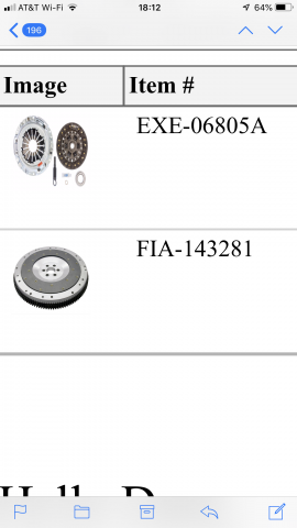

  1. Update: So I changed the clutch collar and bearing to the correct one. I compared the clutch collars and it seems to be about the same. So far no problems going through gears. I am testing it tom Am for slippage.
  2. I will drive the car this week end and will let you know. I looked at it. Looks like a do have a standard 5 speed with the 2 ears. Looks like a wide or normal ratio 5 speed. but which collar to get? Hehe
  3. Hello all, ty for the response. Can you please clarify the slip test clutch? I from what i know that i can put the car in high gear and do WOt and check for slippage/ can you please clarify your test. btw the accelerator being stuck is from the carpet. I drove the car today, it’s fine with normal driving. Didn't feel any judder or slippage on low rpms or load. i didn’t do WOt Coz i wasn't sure of the steps you wanted me to do. Sorry, it’s unclear to me. I called exedy, and offcourse they are saying i need to break in the clutch first before anything so far i did put atleast 300 miles. They are telling me to do more, and it has to be no Wot and not that much load. The clutch i bought is rated to 221 ft lbs. I’m not sure of where i’m at that power. the collar In the pix is the one i used. Basing on this kit, this is the right one, but who knows if it isnt. I have to look and see if there is play between the fork and the bearing. So you’re saying there should be play? Any words on the proper clutch collar? I bought the clutch collar and bearing from motorsport auto. Thinking maybe the bearing is a culprit. I can’t remember anymore how I installed it, I'm for sure i did put the clutch correctly.
  4. Need help diagnosing. Car is a 260z with l28 5 speed, triple Sk. So I have changed my clutch and flywheel. fidanza aluminum flywheel exedy stage 1 organic clutch 225mm Sachs slave cylinder. After breaking the clutch in, 1st gear 3k load WOT, my clutch slipped and my accelerator got stuck and the rpm reved to 8k rpm and had to turn the car off then then the accelerator went back. This happened before as well henced I changed the clutch and flywheel. attached are pictures of tranny, items and the clutch collar i had from before and also the tranny with 2 tabs. First not sure why the accelerator gets stuck then comes back normal, but i had to turn the engine off. Second, the clutch slipped during Load.
