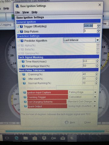

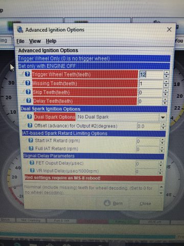

  • Donations

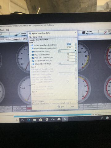

  2. Well I never got it running so I was just gonna start from scratch. And thanks for the advice I loaded the firmware and now I have all the options and I put the ignition options in and wasn’t too sure about the fuel I’m running stock l28et injectors he’s a pic of the setting I put it on. I did all that and it started up for like 2 secs but did not idle. I still have to phase the dizzy would that do it?? Thanks for everything

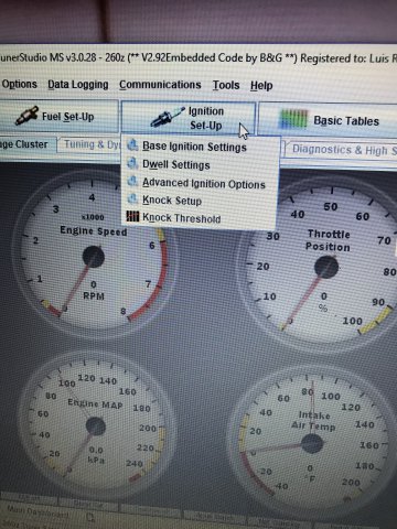

  3. Thanks for all the info I’m gonna load the latest firmware in a bit I have 3.0.2 I believe. I’m pretty sure I have the disc the right way but I will double check. And I do need to phase it. But my ignition dialog box on tunerstudio does not have all those options and looks way different here’s some pics of them.
