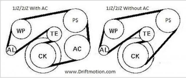

  3. NewZed, now that is a fresh idea. Another off the wall idea I had was moving alternator to PS spot with fabricated brackets which increases the some pulley contact instead of decreasing.
  4. Thanks ZHoob2004 but I am not sure that is enough contact with the CK or TE. Even the No AC No PS has a quarter of the pulley contacted and that is the least I have seen. I talked to someone that said they custom one off'd an idler pulley to make it work but I have not even seen a picture to submit for custom.
  5. Is anyone aware of a replacement pulley for deleting the power steering or another methodology of keeping the AC and not the power steering on a 2jZGTE going into a 1978 280Z. I see plenty of swap pulley systems that delete AC or delete AC and power steering but none that keep the AC and not the power steering.
