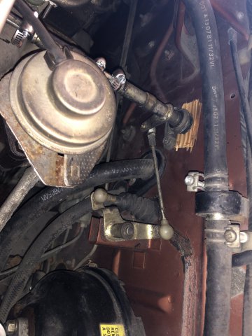

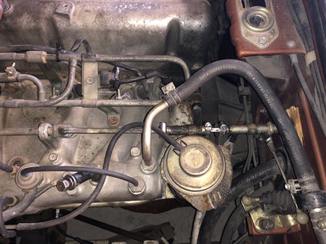

  1. Yeah, I think I recall them saying it was too short and they were going to “fab something up” 🙄
  2. And that would make the springs fight each other. Right now everything feels like the springs are far too weak.
  3. Very cool, I bet you’re right about it being backwards because the pedal does nothing for me. Thanks!
  4. Yeah, pictures would have been a good idea, my bad. I have attached 2. I will try the intake manifold swap. Luckily I have the original S30 manifold because I don’t have the exhaust. The previous owner broke a bolt off in the block, which is why I did this swap.
