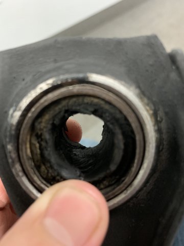

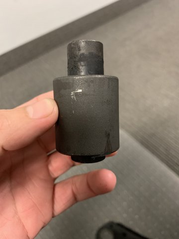

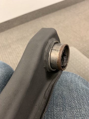

  1. @ZHoob2004 i’m in the west valley and @JMortensen really wish I got this ball rolling sooner on here. I already purchased some control arms and they should be here today. Thank you both though i’ll post up on the forum next time I need something. Think i’m gonna use the burn and saw method on these guys. @grannyknot that’s what i’m thinking.
  2. I bought the rubber bushing kit from zcarsource. Little expensive, but I think it will be worth it. @silverado22c thank you for your input. I appreciate you trying to help! @JMortensen So both bushings slide right out of the control arm, the old stock bushing and the new one. I’m thinking when the shop pressed out the bushings they ended up messing up the control arm hole where the bushing sits.
  3. @silverado22c I apologize for the delay, but I finally got some pictures. Can confirm I definitely have stock looking rubber bushings. Not sure if the picture will really tell you much. The new bushing also slides through like the old stock bushing.
  4. I will be happy to post pictures when I get home. I don’t believe they are poly and if they are, they are being sold as rubber. Unfortunately, when I went to press the bushings in they slid right through the control arm.
  5. Recently had a shop press out my front control arm bushings. Went to go put in my new stock rubber bushings and they slid right through. I still had the old stock bushings that were pressed out and when I went to seat one of those, it also fell through. It doesn’t look like they damaged the control arms when they pressed the bushings out, but i’m not positive they aren’t damaged. Am I missing something here? Also, when compared side by side the bushings seem to be the same size. This is for a 78’ 280z.
