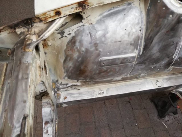

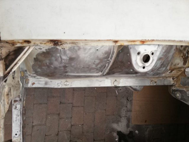

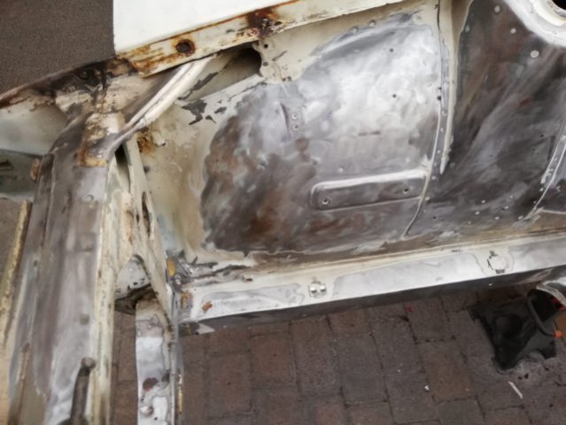

  1. Yeah that's what I thought it might be at first glance... But it's way worse than the left side and you can see that the metal was pushed into the enginebay by a bit (in the last picture I posted) . And that's what I'm concerned about bc the plus of material has to come from somewhere... But I guess I'll just wing it and cut that section out to replace it. I was in the process of stitchwelding the enginebay (left side) when I noticed there was something not quite right with the other side... And I want to get a cage put in
  2. Hey all, While taking my 73 240z apart I stumbled across some weird deformations in the front right wheel tub and it seems like the radiator support hast been out of the car and put back in. When I bought the car everything looked and fit fine (front fenders etc.) and still does when I put stuff on. Only spot that doesn't fit perfectly is where the right side fender is mounted at the bottom in front of the door. There's a space of like 1/2" (1,5cm) between the mounting point and the fender itself. And there is a dent on the bottom of the right side frame rail roughly a
