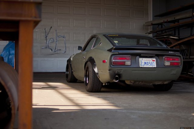

  3. Yep I've checked those out. This fella in the first link is running the 15x10 -38 (4 bs) front/15x10 -25 (4.5 bs) rear setup on what looks to be standard ZG flares. Doesn't seem to poke. Here's another with the same on the ZG flares (the comicartist guy): https://forums.hybridz.org/topic/111568-aggressive-fitment-for-zg-flares/ But still curious about the reasoning behind the staggered (front -38) offset.
