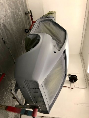

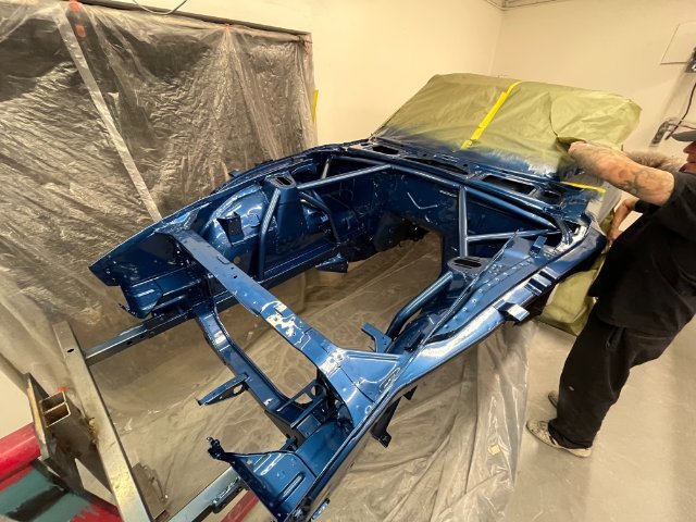

Then it was off to paint. The boys did an amazing job! Worthy of a $50 bottle of tequila and a celebration! -

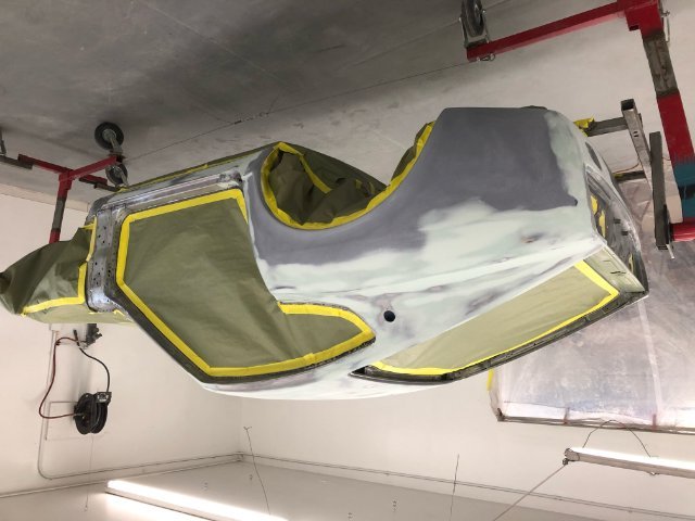

We did a lot more paint prep than we should have, because the painter was not going to apply his paint over someone else' prep. But I think we did save a lot of his time, by taking care of some problem areas, especially where the rear fenders did not quite fit the damaged sheet metal behind them. -

Z Trix bodywork was a custom fit all the way. We trimmed the rear fenders along the top shoulder, then scarfed the back side along the edges to get it to blend into the existing panel. Applied a seal coat, then bonded them on. The front fenders required quite a bit of work to get the hood gaps right. Lots of small problems to solve, but it came out well. I'll let the photos tell the rest. -
