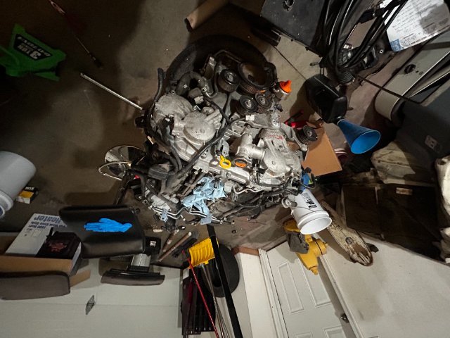

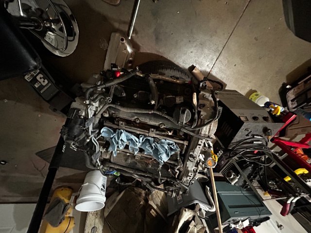

Hello all, it’s been a good while since i’ve made any updates towards the build. So after purchasing the CD009 (i’m pretty sure it’s technically a CD1 code…) i’ve been focusing on the teardown of the VQ. I had purchased a low mileage VQ37, from a G-chassis kid, that clearly had been sitting after being oh so delicately ripped out of a G37. Silver lining was an aluminum block, with 93k miles and $900. what he has neglected to tell me was the G-car donor was AWD. Made the odd splined-spindle system in the oil pan make more sense lol. After popping off the oil pan i found maybe 16-18oz of water mixed with the oil. While this would freak any rational petrol-head out, I kinda expected it, due to the top of the engine missing a few coil packs/spark plugs, and being turned over multiple times to check for seizing. So a simple flush of the engine after a thorough inspection of the bottom end should be just fine. All gaskets are getting replaced and heads are already getting resurfaced. The engine is still awaiting removal from the Z31. I just recently was able to get the intercooler system removed, which for some 80’s Japanese-Technology reason is fully attatched to my pre-freon A/C system. A few questions that have stumped me lately, are the input shaft from the transmission (might be completely wrong term) going into the crankcase, are the splines going to fit correctly, or when i mate the transmission to the engine will it be a case of “square peg, round hole?”

VQ37VHR Update #1 (w/ pictures)
It’s been a fairly eventful year since the last time i’ve posted. As I was in the planning stage, now I have been able to acquire the funds necessary to get this build of mine started. In this past year i’ve written out and budgeted a parts list for each and every category, and if I haven’t, it’s a matter of time. I have gotten my place of working on said build finally up to standard to begin said project including the tools. And i have finally acquired a 73k mile VQ37VHR engine, for $900. The engine was picked up in Omaha, from a G-Chassis driver. Compression tested, water pump, Gallery Gaskets, and Timing chain all redone, it was prepped for an engine swap. Getting this engine in my garage, admittedly was a milestone that i’m actually gonna force myself to see through this build.

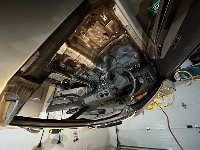

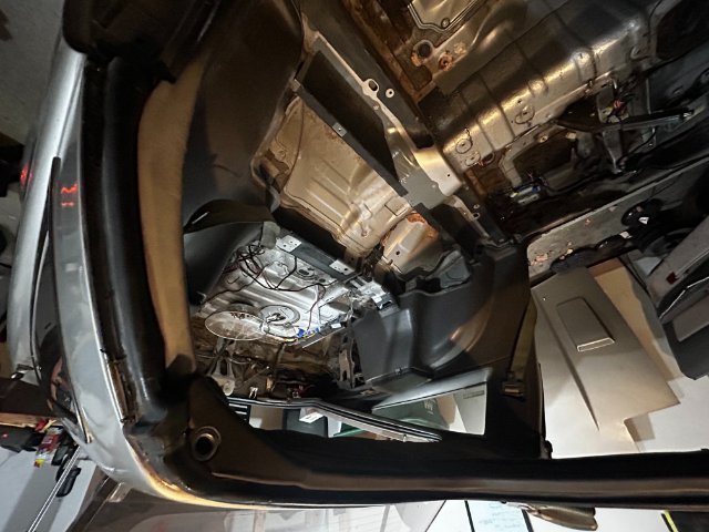

As of right now, i’ve began to strip down not only the engine but the car itself. I’ve taken only the top intake cover, and removed the flywheel for mounting. As for the Z itself, i’ve removed all of the seats, trim, carpet, and center console. I will be attempting to keep everything in tact, so if anyone’s looking for spare bits i’ll be open for any offers here in the near future.
If I haven’t been too clear on what exactly this build is, I am fabricating a full tube-frame chassis, to mount a VQ37VHR engine to a CD transmission, Fully built to fit the grey area between the Iowa Resto-Mod Qualifications as well as the SCCA Super Street Modified Class rules. The vehicle will run on E85, it will weigh 2,500lbs, and I want at least 425hp to the wheels, completely N/A.

As far as engine work, I don’t plan on doing too much to the VQ, so long as the equation in my head goes correctly. I’m currently planning:
-E85 Tune
-Jim Wolf camshafts
-lifters/valves/springs
-dual catch can
-a custom-designed tubed intake manifold
-side-pipe exhaust
-high-flow exhaust manifold
-Sending in heads for resurfacing/porting
-Walboro Hellcat 525 Fuel Pump
-Z1 Billet Fuel System
-Z1 Injectors (1000cc)
-Haltech ECU
-Battery, Filter, Line Relocation
-etc.
I have seen a few great examples of a baffled oil pan, as well as a great dry sump oil pan system on the aftermarket. If there’s anyone who can help me figure which would be best, please comment below.

The next step is headliner, dashboard, and slowly but surely begin the painful process of properly removing the wiring. I’m thankfully in a state where dry ice isn’t hard to come by, so I’ll be removing the sound deadening soon.

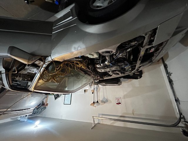

Hello and welcome back the pandemonium of inevitable self-destruction! So, the car is now up on jackstands, and I've made the plan for the upcoming summer, and figured I'd update any and all with the long-awaited photos I'd promised. So, the current plan is, do one last good tune up, and really just enjoy the car one last good time, before the summer either ends, I find the bits and ends I'm looking for earlier than expected, or lastly, send the 115k mile engine on its final farewell, as its currently leaking oil, and pissing gas on the cylinder heads.
I'll be the first to tell you, that the more digging I do, (and throwing engine and transmission mounting out the window), the more realistic and feasible this is all turning into.
First off, I'm currently on the hunt for 2 separate vehicles. First, a similar year, two passenger 300zx. Doesn't have to be perfect, or even running for that matter, but having a donor chassis, especially with some of the availability in the Midwest, a good deal shouldn't be too hard to come by. Second, I'm on the hunt for a '12-'18 model 370z. This will be achieved by going through salvage auctions and looking for a model with damage to the body. Hail, rear end, side impact, all perfect, so long as the engine and a code 'CD-8' CD-009 are intact, it'll be used. Just browsing the sites, I'm sure it wouldn't be a stretch to find a full powertrain in a salvage chassis for under 3 maybe 4k. So, let's do the math, a decent donor z31 for anywhere between 1-2k, and a powertrain donor for around 3-4. Worst case scenario, I'm paying a grand less for what the powertrain would cost me new all by itself.
Now that we got the part sourcing out of the way, how in the hell am I going to fit the beast into the current chassis? The chassis itself, is fairly rust-free for being 30+ years old, only bits being a quarter side hole near the driver side floorboard, a patch growing near a hole on the rear hatch, and a bit of the frame is going to need some persuasion and reinforcements, all of which perfectly manageable with a sand blaster and a tig welder. It's going to be a mix of rag-tag, backwoods, redneck magic, and proper CAD software, and hopefully a couple gurus on sight to make sure I'm not actively making an ass of myself. The mounting of the engine and transmission are weirdly enough on the back burner, more-so how I'm going to mount the suspension, and make it play nice with the front axles and such. I can show some base sketches if you'd like but I'm going to preface by saying I'm not a professional and/or any kind of engineer by any-means, this is all a passion project. I figure I can fab up some kinda strut-plate through what would in essence be a fender bar/reinforcement, then making a strut brace off of that very setup. Another thing to take into account is how my exhaust setup would be, and there has been some debate in my shop what kind it should be. We ultimately settled on a x-pipe design straight from the engine to the side skirts, old-school corvette/'rat-rod' style if you will. Whether the exhaust tips should be a Nascar boom-tube or a large A/C Cobra tube on each side is still in the air (how subtle do I reeeeeally wanna be here? lol)
