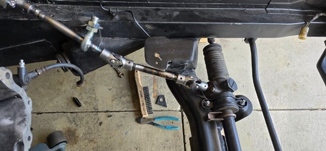

  8. Thanks for the links, saved me so much extra work. Here's the new layout, seems to operate smooth, clears everything. Hopefully I didn't miss anything important....
  9. Sorry for disappearing for a hot minute... the starter is up and out of the way, its the rubber isolator and mount bracket that end up blocking the linkage.
  10. Hey guys, I'm in the process of an engine swap in my 280z. The revised motor mount makes it necessary to change up the steering linkage, does anyone have experience with using an aftermarket steering linkage kit? I'm looking at the ones that add a joint to work around the mount. Do these negatively affect the steering feel? Anything not obvious I need to keep in mind, or is it pretty straight forward?
