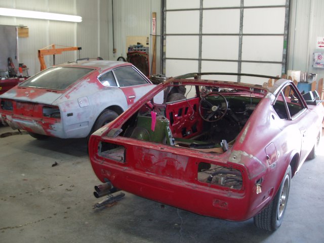

The factory pans have been replaced and I can see both sides of the after market pans no rust lucky me.
So I have a donor 73 with after market floor pans rust free. And a 71 that I am building would it be unwise to cut the 73s floor pan out and put them in the 71 witch is need of floor pans. I would not be using the frame rails, I will be buying new, so if you have extra you want to sell let me know. I am not an expert on this topic so all positive advice is welcome. 73 has no roof 71 has roof
