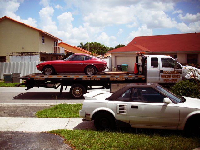

	Well, seems like there's alot of new Z owners lately, maybe it has something to do with the crappy economy. I've always wanted one, and now seemed like a good time to buy. Anyway, after about a month and a half of searching and negotiating, I finally settled on this early 71 240z. It's got an L28 block with an early E88 head and SU carburetors. It's also got a decent sized speed hole under the driver's seat, that I'm gonna test my nonexistent welding skills on. Needs some fuel work to get running (starts fine on starter fluid) so hopefully within the next two weeks I'll have a running Z! And here's the pictures! 12pm today, delivery! Pwhew!
