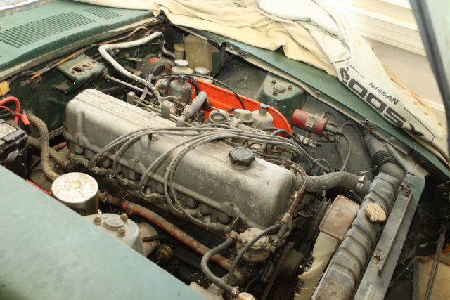

  2. First update to add, no new pics. Got down to my parents house, and made all the preparations to get it the Z started up again. Unfortunately we ran in to a few issues, first was spark. That was resolved by replacing the condenser on the distributor. Second issue was no fuel, unfortunately we didn't have time to work this out, but we are going to check the mechanical fuel pump and the fuel lines. After the system was primed, and we had oil pressure, we were able to get it to light using starting fluid, so once we figure out our fueling issue it should start (fingers crossed) We did find out that it has aftermarket Front and rear sway bars (Suspension Techniques in the rear) and a urethane steering coupler. Bonus!

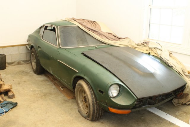

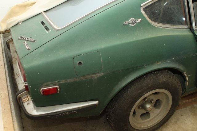

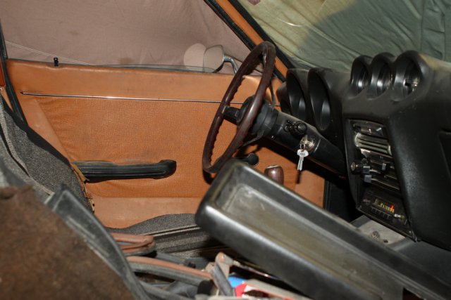

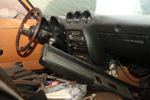

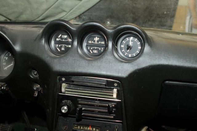

  5. Over this last weekend (5/26/2012-5/27/2012) I picked up a 1970 240z from my dad. He used to restore them for a living and as a result has a few laying around. The one I picked up is pretty much rust free, and was running before it was parked where its been for about 10 years. I'm going to use this journal to keep track of progress and lay out a plan for my self and for others who may be interested. First up, the car as it sits right now:
