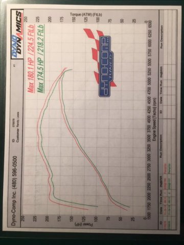

Sorry, I misunderstood. Yes, re-checked the relationship between the cam and the crank and everything lines up properly.
Not sure what you're asking, "on ignition." I'm measuring the maximum amount of distributor timing, which comes in at about 3000 rpm. I'm not running a vacuum advance. Are you referring to something else?
bradyzq, I was a little mystified by that fact as well. When I dyno'd it I was running 34 degrees of total timing. I have since dialed in another 2 degrees to 36. The rpms were even lower until I changed out the SU needles for some that were much richer at top end. I'm going to try an even richer needle at top end to see if I can bump the rpms up a bit. Any other ideas?
The top sheet overlays torque and horsepower. The bottom sheet overlays horsepower and AFM readings. I have some work to do to lean out the AFM at lower rpms in order to flatten out the curve. Likely will be experimenting with some different needle profiles. Car is very fun to drive and was build to be very streetable with zero detonation issues. Planning to open up the spark plug gap slightly from .032 to .035, dial in 2 additional degrees of timing and re-check valve clearances and I may tighten them very slightly. Oh, and obviously I'll try higher octane fuel next time (91 octane).
Just had a baseline pull done on my 72 240-Z with NA L-28 motor. The block is a F54 with dished stock turbo pistons, E-88 head with valves unshrouded and and some port work, cam is 480 lift/276 duration, running stock cast iron manifold with 2 1/2 inch exhaust and straight through glass pack muffler, Pertronix ignition, re-curved distributor running 34 degrees of total timing, SB profile SU carb needles and ITG foam air filters. Pull was with 87 octane fuel. Best pull was 180.1 HP and 224.5 Ft Lb Torque. No dyno tuning to date but with some very minor adjustments believe I can squeeze another 10 HP out of her.
