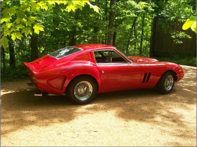

I would not hesitate to transfer the fiberglass body to a New Donor Car. I have seen Z's with complete new tube front ed nd and suspension. That's an option. Mine was built in 1990 on a 73 240z. It came with a 283 SBC. I knew I wanted a V8, and bought a donor already done. ArizonaZ, which is like Alpha. Big hood. In 92/93 my daughters were born. I drove about 300-600 miles a year. Then Zero miles for last 5-6 years. I parked it 1/2on driveway and 1/2 on dirt. ..slight uneven...and it but a slight twist pressure. That caused the top Bond to separate. (I used marine epoxy). Water got in there and I now have rust. Could peel it back, reglass it. I would not hesitate to cut the body off !!!!! (no time tho Reverse engineer use an installation a manual. Lol, I'm going to sell my body kit, FREE Delivery, comes with a 1973 240z. No trailer needed- 40 replies

I have no experience with the VR trunk Lid, but..... With the 1st generation GTO nose, "long hood" there is only 1 1/2 inches between the Sugar Scoops and the leading edge of the hood. I had always noticed how wavy other cars were right there. Someone must have suggested, can't remember, but I bonded a long strip of 1/8th inch steal under that thin strip of body. I had drilled and pre-tapped 4 holes spaced from the ends and between the scoops. With another tapped strip bonded to the inside bottom of the nose, I installed 4 turn-buckles. My hood to nose alignment is always perfect !! Adjustable I don't know if you have room to bond a "stiffener" to your Trunk Lid. Just a thought

I wonder how many ways people Bond their GTO body to the Roof. Mine has delaminated right where they meet, as it is a Flex point of the body (hence the lead filler from the factory). I used the Marine Bonding glue I think was suggested by Thunder Ranch, 17 years ago. My Door Skins Remain Perfect, a common delamination point. I want to Re-do mine. It was suggested to grind back to Metal on the roof and Fibeglass the Clip to the Roof. Feathering it farther forward onto the roof. What are peiple doing these days?
OH. SMOG. I believe by age a 1973 is Calif Smog Exempt. I have been thru many changes in Cali Smog laws. My 250GTO, v8 was converted by previous owner and I now have it titled and smogged as a 1962 passenger car !!!!!!!!!!! huh? Yep and WOW....weird
Just got back into all the forums and Z based discussions. Love This Stuff! My GTO has sat for the last few years, always Registered, rarely driven. It is: 1973 Datsun 240Z with ArizonaZ GTO Kit (Large Hood type Kit). I bought the Z donor car already converted to V8, Complete with 1962 SBC, 283ci, Automatic Trans, Air Conditioning. Mallory Ingnition. Electric Fan. Oil Cooler. Great running order. About $12,000 invested. Valued at $15,000 to $18,000.00 Runs with 289 Cobras! Needs re-paint after minor repairs. Bonding of rear clip above Hatch needs attention. Feather the Bonding But NO door delamination (a common problem with poor installations). Gas Filler moved inside, needs re mounting. or mount outside Needed New Key and switch, just bought one off ebay. I'm getting a new battery and sorting out the running. Custom Dash '62 Corvette Outside Mirrors Wire Wheels New Windshield. Electric Doors, Alarm. EXTRA rear hatch, Pantera Style !! Mounted, not painted. Newer Black/Silver Interior, carpeting, panels. Reupholstered Stock Seats - Black with Red piping! Extra set: Low-Back Seats from an AlhaRomeo, Reupholstered - Black with Red piping, never used, I am 6' and they didn't work, good for a 5'9" or smaller driver....Bolt right in tho'. Austin Healey Running Lights. Italian Guages One-Off dash Cover Head Light Covers, never installed Alloy For Light Rings Stereo and Electric antennae Spare 283 heads, Hardened Valve seats Many Farrari touchs Many Z Parts Still have all Datsun Z parts that came off. L & R Fenders F & R Bumpers LOUVERED Hood !!! 2 rows Tail lights etc. NOT quite turn-key, due to sitting. All repairs ARE cosmetic. Would entertain Porsche Kit Trade, 356 or 550, any condition. $8,000 or best offer. Even with a custom paint job and repairs you could NOT build this for under $10,000 $8k Thanks, Patrick Orange County, CA
